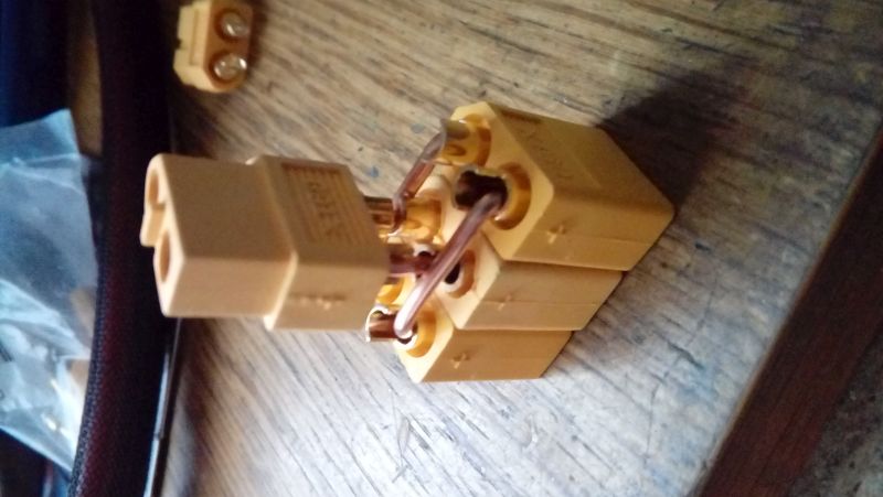

If I was to make up a 3pack parallel lead and was using xt60 connectors would I use 8 or 10awg?
8awg is way to thick for xt60's, you can get away with 10awg (just) but xt60's are designed for 12awg.
the best way to make adaptors is using thick copper wire, hot glue and heat shrink.
for a 3 way xt60 P adaptor set it up like this ....
20170214_103106.jpgsolder well ( no shorts!! )... then completely fill the gap with hot glue then cover with heat shrink..
the hot glue will make the whole thing rigid and insultat the connection from the elements then use heatshrink to make it look nice :-)..
