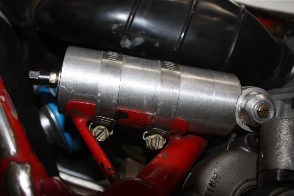

Looking for some advice is the rear shock non remote type interchangable with the type with the remote as my shock is not very good and i have been offered a good shock with remote hopefully this will fit look forward to replies Alan

I have a TY350, 1985, that did not come with the remote but added a mount for the shock I built, so it will work. I used a piece of muffler tubing cut lengthwise and a small brace. I can pull the reservoir to give a better view if you need it.

Yep you can swap them, you can even fit a TYZ shock with remote.
