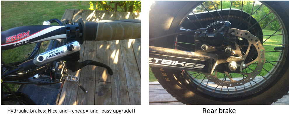

redondo76 Posted October 9, 2013 Report Share Posted October 9, 2013 Hello, I upgraded my son's Oset 16 36V (now modified with Kelly Controller and 42V LiPos) with Shimano Deore BR-M615 M610 Hydraulic Disc Brakes. If you know how to bleed off (air) the brakes you'll be able to "re-use" the welded wire guides. Very good upgrade and simple! Eirik Link to comment Share on other sites More sharing options...
