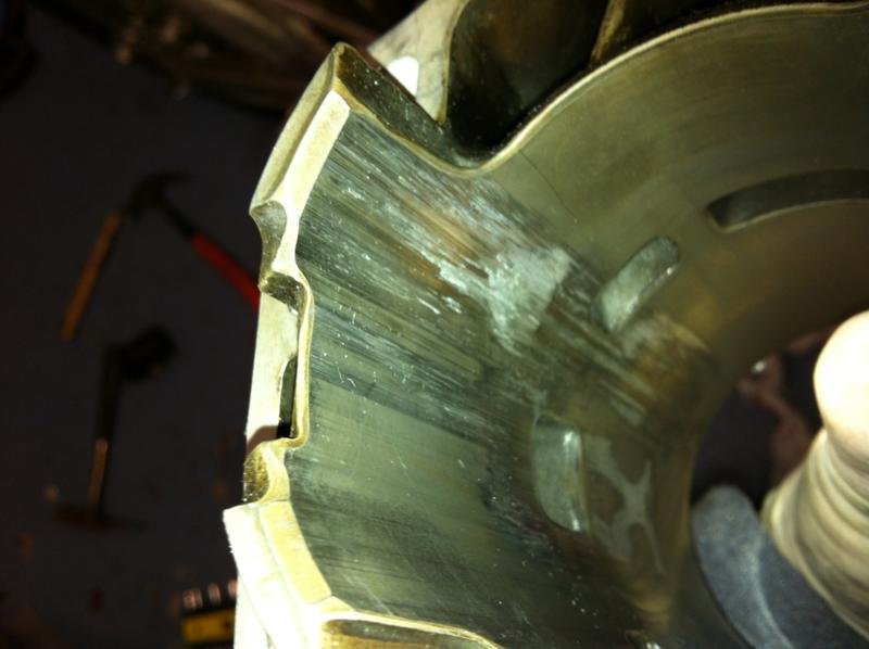

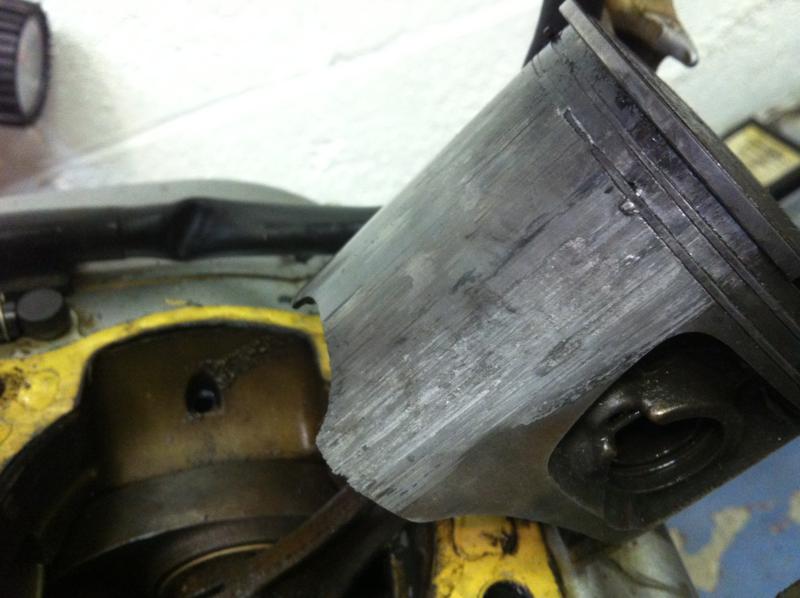

its in bits now and the cylinder/piston is FUBAR'd.
dont know how to post images but i have them!
sorted the photo thing.
this is what i found tonight... not good
The concept behind the lanyard is that when you get seperated from your bike it kills the engine before it his the ground and revs out on it's side..looks like you have the same job ahead of you that i'm going through now...once you get the piston off check the rod for any up and down play from the big end or mains.

Hard to bear kidda, I hope that the bottom end doesn't have too much swarf in there :(
