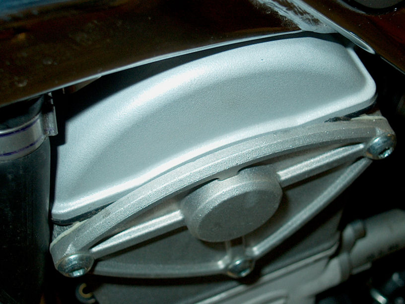

Yes, did have a half hearted go, just to have a look at the decompressor!
See attached picture, cover is outside and under frame rail, it cant be lifted
and across as the plug tunnel stops it(?)
Cheers

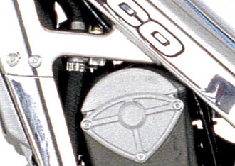

Uh, really tight, it's true :lol: The prototype I tried had enough play to lift a little and save the 'plug tunnel' edge (it is an independent tube and remains free between head and cover). Maybe they have changed the chassis in the final series? Look at this photo of the early prototypes...
What says your dealer? Have you any manuals?

Yes, they have changed something, there is significantly more room
in your picture :lol:
