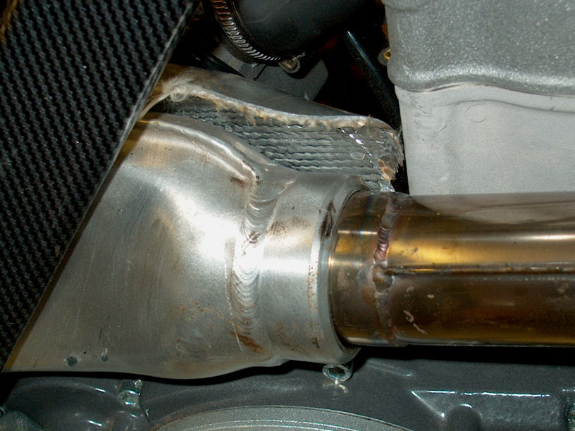

I can understand how the mudguard melted..mine gets too hot to sit on and as i said to Big John, even the frame rail gets too hot to touch!
I have already spoken to a F1/Champ car exhaust fabrication company to see what we can replace the silencers heat shield with. I have emailed him with photos of the sheild/insulation. He had some excellent suggestions as to what to try, unfortunately he's off on holiday for the week!
see pic of heatshield, unscrewed from silencer...seems a bit thin in insulation.
Cheers
