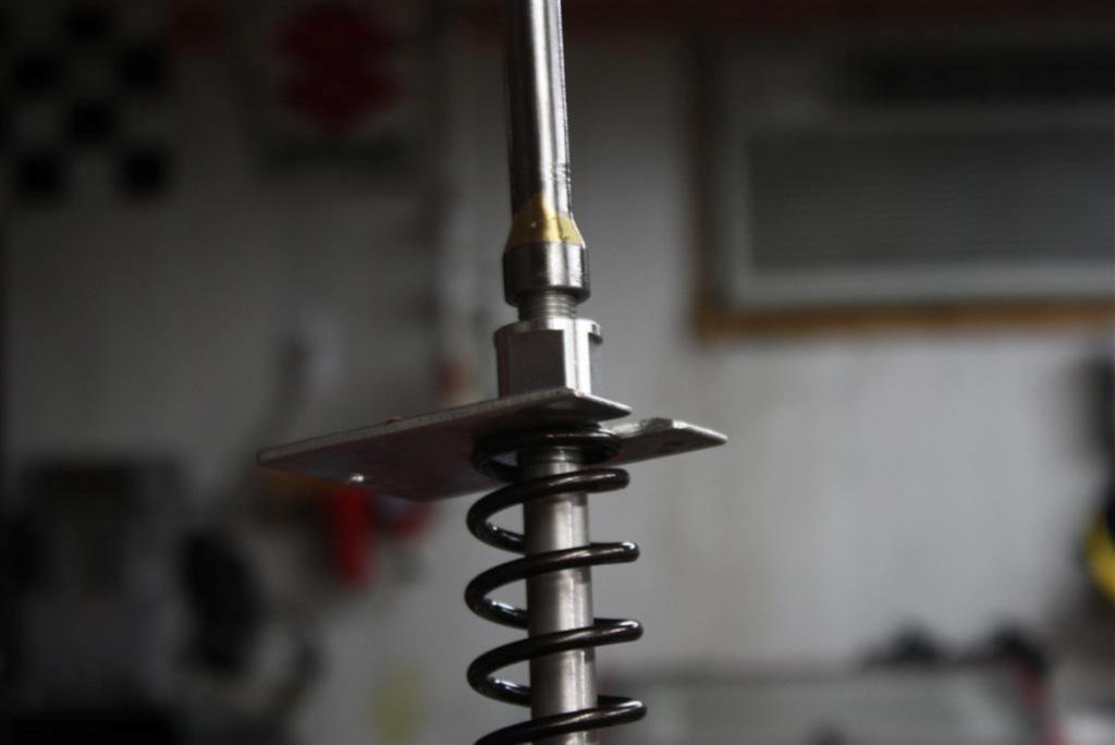

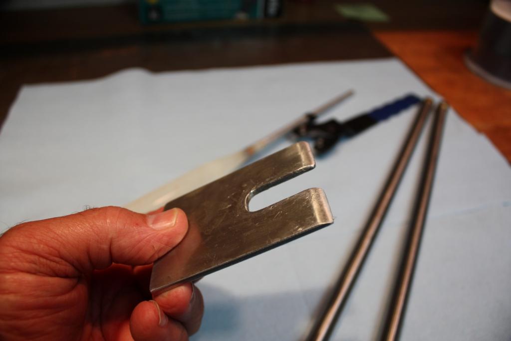

Yes, both legs. You might consider making this simple tool to hold the spring down when removing/replacing the top cap. That's a bleed tool where the top cap would be screwed on.
Jon

What's the bleed tool for?
