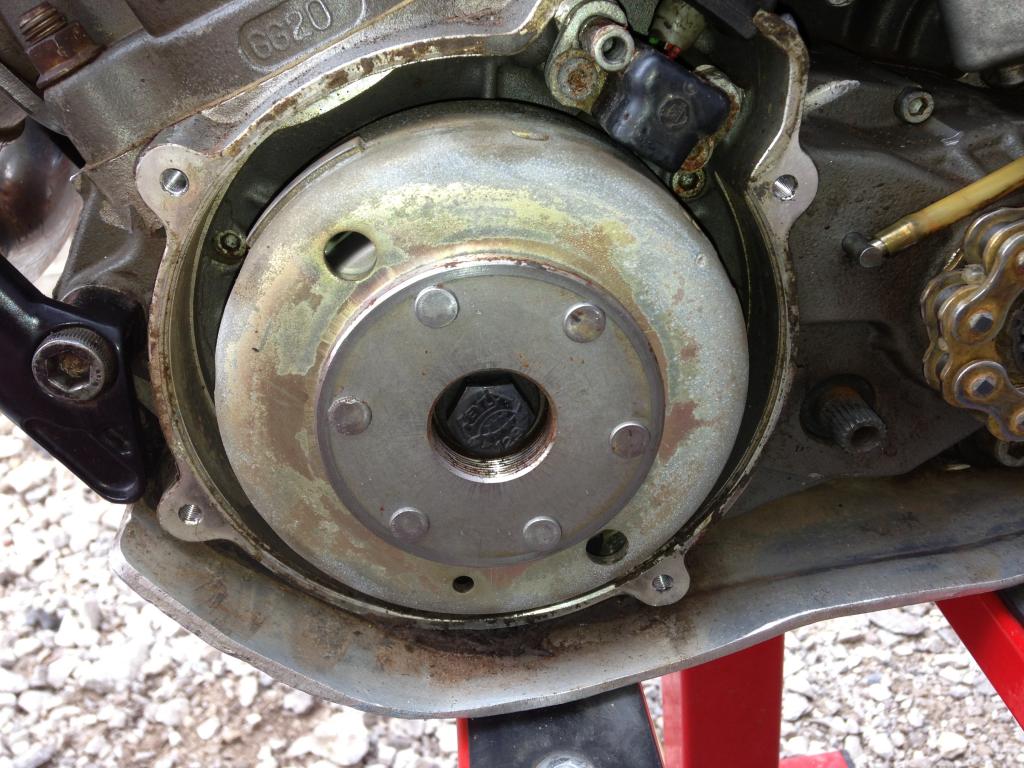

Can you post a photo of your stator with the flywheel removed

I took the cover of the flywheel and it was a little bit of moisture there but nothing serious, am I right in thinking I need a special tool to remove the fly wheel? And also should there be a rubber gasket between the cover as mine didn't have one?
