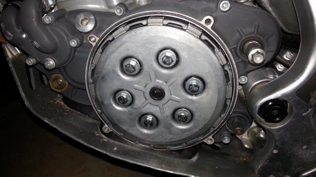

Lie your bike on its right hand side, flat on the floor. Remove kick start lever and gear leaver. Remove clutch cover. You will see 6 bolts and springs holding the aluminium clutch together. Remove 2 of hese bolts and their springs. The 2 you remove should be opposite one another. Then grease up your clutch cover o ring and put it all back together. Very simple.
When the clutch cover is off, itll look like this. Remove 2 opposite bolts with their springs and top washers.
You lie the bike on its side so you dont have to replace the oil. Thin layer of grease on the o ring helps it not leak and stay in place when you reasseble.

I decided not to remove 2 bolts as I feel it was built like that for a reason. Had the pic from doing the dan williams clutch mod, to make sure I put it all back together right. Lots of guys have done it with great success but also with slippage with the guys that hang on the throttle.
