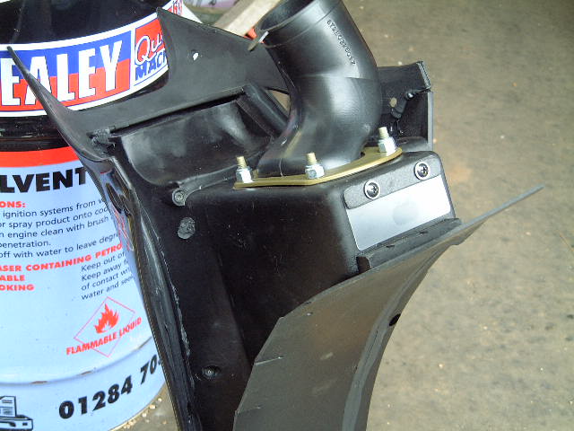

You can get a kit which comprises a plastic plate which fits over the exhaust front pipe and covers the open area of the A frame in front of the barrel, and a small mudflap to fit on the bottom of the front mudgaurd. This stops a lot of crap getting into the airbox inlet behind the fuel tank. The kit is under a tenner. Try Haven Trialsport 01469 532600.
