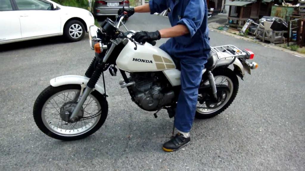

I've recently bought a CT 250 SC Silk Road which is almost identical to the CL 250 SC.
I have been told the engine is the same as the XL250 and CB 250 RS of the early 80's.
Can anyone confirm this and is it the same engine as the TL250?

Picture of similar bike attached
