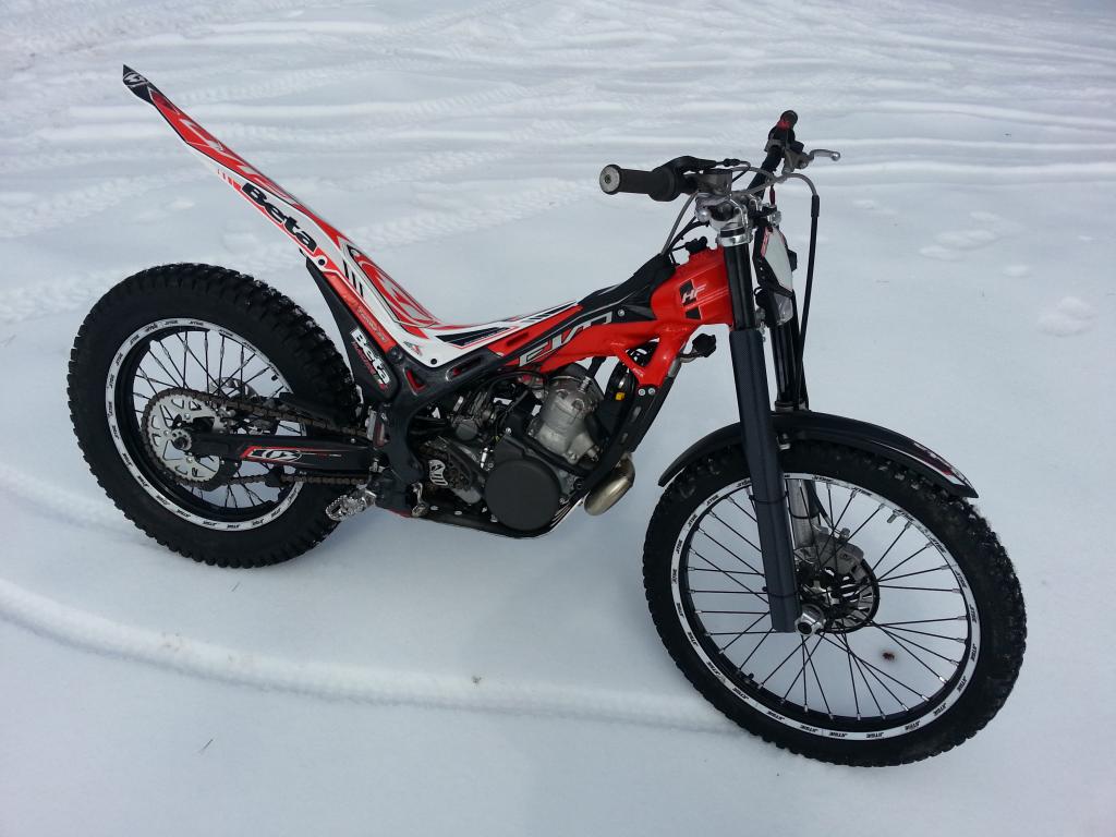

February 9, 201412 yr Have a new to me 13 evo 300. Finally mustered the nerve to switch to Map2 setting and found that pressing the button does nothing. It will press down but will not click into the down (#2) position. Is there a process that I'm not aware of? Sweet Bike!
February 9, 201412 yr It may be that some dirt has got down inside the switch mechanism, but more likely that the push switch locking mechanism is stuck. Push the yellow mapping switch button up and down a couple of times to make sure it is free. Then when fully up (position 1 - softer power) gently pull it up and waggle a little with your fingers, you may feel/hear a click. Then push down and it may hold in the bottom position - position 2- quicker response. Obviously, only change the mapping when the engine is stopped. This should do it!
February 9, 201412 yr As above - but as it looks like you are in cold conditions that might also effect the operation.
February 9, 201412 yr Author As above - but as it looks like you are in cold conditions that might also effect the operation. It may be that some dirt has got down inside the switch mechanism, but more likely that the push switch locking mechanism is stuck. Push the yellow mapping switch button up and down a couple of times to make sure it is free. Then when fully up (position 1 - softer power) gently pull it up and waggle a little with your fingers, you may feel/hear a click. Then push down and it may hold in the bottom position - position 2- quicker response. Obviously, only change the mapping when the engine is stopped. This should do it! Yep, that did it. It's pretty cold here with ice on the snow so I cant really ride it yet. Shipping was delayed and its been North Pole since, but at least I can finger it. I'll run tuner cleaner and dialectric when its a bit warmer. Thanks
