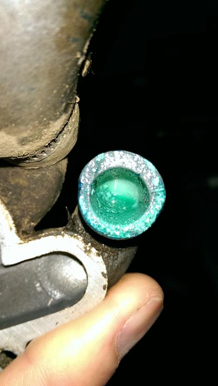

Head been in the oven. New gasket and still the same. Put the head in my dad's lathe and found was out so new gasket and try again.. still the same starting to think it's not the head... The top of the rad is red hot but the lower of the rad cold.. but have had the water pump cover off and the pump turns and the pipes are on the corresponding outlets. May be it's circulation.. As I did fit new aluminum clutch cover ..
Afte all that found this in the water pump cover. Only found by removing the pipes and starting the bike and found the water wouldn't move up or down the pipes.. at last sorted
Seth29..
