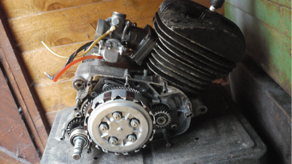

THIS IS THE ENGINE VIEW WITHOUT THE CRANKCASE SIDE ON
THIS IS THE CRANKCASE SIDE (smashed)

Your clutch case looks like it has been repaired previously

It looks like it would repair fairly easily, find a good tig welder to do the job :thumbup:
Sorry, already had it welded before but now its cracked in 2 places and shatered on the otherside so i need a new side for it as the one on tytrials is to much.
