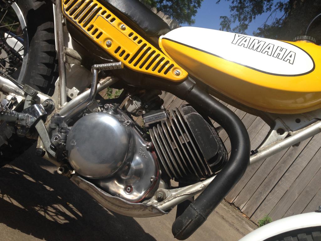

Here's what the YZ cover looks like on my TY175. SWEET!!!
Now just hunting some TY250 forks. Or might just enjoy it as it is for a bit.
Which YZ was it that you got this cover off of? I know that there are a bunch of them. I like this piece way better than the MX 100 side case that I finally bought. The most useful link for my search was the one that tony27 gave me for the gaskets.
Thanks for the picture...it looks very clean...way better than the MX 100
