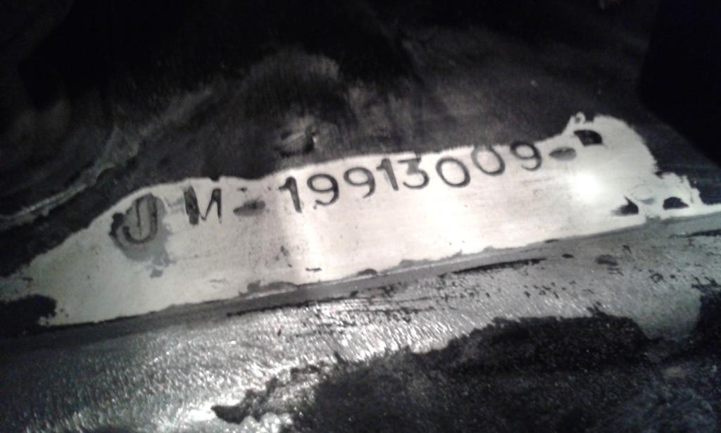

Trying to attach my photo.... Hope it works.
Any observations about the photo above ?...... The 'M' looks like someones try to redo it... and the 'B' is only half there.... Do you think it's original ?
Yes they're stamped from the factory that way. Quality control wasn't a top priority when it came to stamping. I don't think any models I have are stamped in a straight line.

They appear original Bultaco stamps to me. If you look at mine, the 1 is bigger than the other numbers, as with yours, as is the J bigger than the M, and if you look at the M on the 198B engine, the M is at an angle like yours. It seems they were always neater with the frame number than engine number.
I think to re-stamp the engine number, with the amount of metal that would have to be removed to completely erase the original number, it would appear obvious. If it is a replacement 6 speed engine that someone has fitted and re-stamped to match the frame, they would only have to redo the last four numbers, not the whole number.
If you're thinking it is a 5 speed crankcase converted to 6, proper engineering work is required to do that and you have to ask why would someone do it in the first place, as they'd have to have the six speed parts to begin with. Assuming someone would do it if the original 6 speed cases were badly damaged, I'd have a guess that if they had the facilities to convert a 5 speed crankcase to 6, they would have the means to repair the original cases instead.
