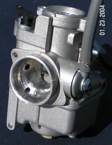

I did some experimentation with modifying the stock dellorto with very good success, made a large difference especially in smoothness and eliminated most of the knock. Also revved much cleaner!
Tell us what the mods were then !!! That would let Peter and the rest of us have a go :blink:

Tried loading a picture with no success, send me your e-mail and i can foreward it to you.
I don't mean to be cheeky but what is a picture going to tell us.
What about settings and all the other guff (don't know all the technip details of a carb !!!) that you modified.

It involves extensive machining and fabricating new jets, have made them mainly for my Son for National comp over here and along with a few other mods made a Huge difference in performance (not a novice bike)! Also made a few for certain people over here, but not on the open until this year for selfish reasons! :blink: Adrian at lewisport has 2 of them, maybe he can give a review of them!
Here is the pic, I hope you dont mind trialsurfer.
Looks like it will help with the air flow and maybe add to the venturi effect, in standard form there is a lot of little restrictions to the air flow which can't do it any good.
I guessing you have to use smaller pilot jet after you have done this mod.
