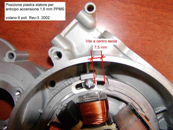

Does adjust the timing on this bike is hard to do ? never tried ....not a clue on how to di it
Very easy to do but you will need a flywheel tool to remove it.
2 different stators 4 or 6 windings. Yours should be a 4 as its a later bike so set it at 2.2mm (assuming its the same as the 250)
This is what it looks like but its the earlier one.
http://www.trialscentral.com/forums/uploads/post-1592-1140382977.jpg
Easy to change it back to what it was if you mark it before you change it :)

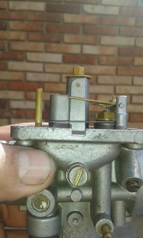

I attached this pic from my carb, when i cleaned it last week.. Does this level looks right to you guys ?
