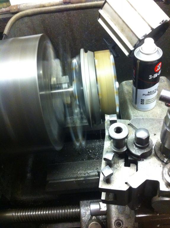

About your brake re-lining and turning down the friction material on your brake shoes.
For maximum braking power, the entire surface of the lining of the brake shoes should make contact with the brake drum.
To achieve this, you should put shims between the cam and the brake shoes before pulling them tight against the cam, as if you would be applying your brake a little bit.
Then you should turn down the lining to the exact diameter of the brake drum.
I hope my English is a bit comprehensible :unsure:
Skim like this...
note: the 3 in 1 oil in the picture is not desirable on the shoes!!!

Smelling how did you hold the shoes tight against the cam?
A thought I had along this line was a small turnbuckle, there I go over thinking again, Ralphs zip tie & wire worked for him,
haven't tried it but we know it works.

Just used the standard spring and some lockwire. Very small cuts (0.05 - 0.1mm with a sharp tool.
