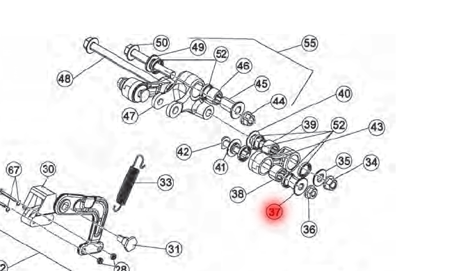

Hi,
My bike ha developed noticeable play in the rear suspension...
Took it to my # 1 suspension tuner ...
And when looking to the source of this play... he found the SAME SPOT for other 2 2012 factory Evos has had the same problem with the same EXACT BUSHING !!
ALL NEEDLE BEARINGS ,AND SHOCK UPPER AND LOWERS are intact.. ( my bike has less than 40 hours )
The Swingarm Bushings are good and so the bearings...
All the PLAY seems to come from this RIGHT SIDE FRONT DOG BONE BUSHING...
RED DOT #37
I called my Dealer on VT and ordered all the REAR BUSHINGS... Just in case...
But guess what ??  The only bushings they DONT have in stock DUE TO HI DEMAND  ... Is the  Bushing that is giving me this Problem !!!
Seems that the Bolt is not SIZED CORRECTLY to the exact ( INNER DIAMETER )  size of this BUSHING... The Bushing is UNIQUE AND LARGER IN SIZE ( INNER SIZE ) compared to the OTHER DOG BONE BUSHINGS !! WHY ?? :wall: :wall: :wall:   Even the bolt that goes thru it is the same size bolt as the RIGHT SIDE DOGBONE... :blush:
WHY  BETA FITTED A LARGER ( INNER SIZE ) BUSHING TO THIS DOGBONE ??
WHY THE OTHER SIDE ( EXACT SAME DOGBONE DOES NOT GENERATE PLAY )) ??? AND THE BUSHING ON THE OTHER SIDE DOES FITS PERFECT WITH THE BOLT ???
HAVE YOU GUYS FOUND THIS PROBLEM BEFORE ??
WAS THIS AN ISSUE ON 2011 AND 2012 300 EVOS ???
(((((      is the # 37 in the Diagram attached !!  ))))

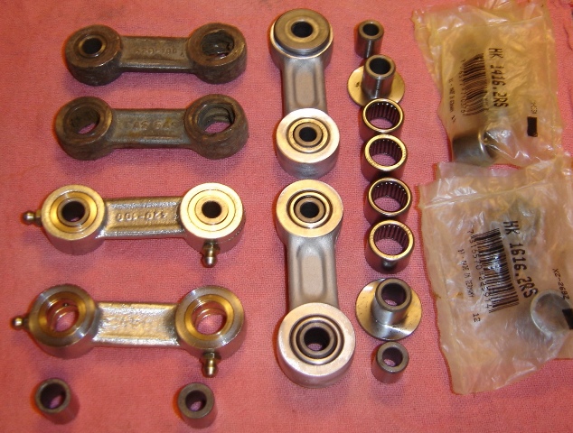

I replaced the dog bone bushes, bearing and seals but I checked the bearing sizes first on the Beta parts list.
I didn't buy Beta's bearing or seals, but bought some quality ones as I didn't know the origins of Beta's ones, I only got the bushes from Beta.
It's true, one end (frame I think) on the dogbone has smaller inner diameter bushes than the other end as the shanks of the bolts aren't the same diameter.
There's 4 part numbers for one dogbone as all four bushes are different.
Two short ones, each with a different Inner Diameter.
Two longer ones, each with a different Inner Diameter.
So one long and one short with the smaller ID at the front.
And
One long and one short with a larger ID and the rear.
After all the messing getting the bearings in and out, (they need to fit perfectly centre with a gap each end to fit the seal) and the feckin' bushes in the right way around, I wished I'd just bought the complete dogbones for an extra few quid!

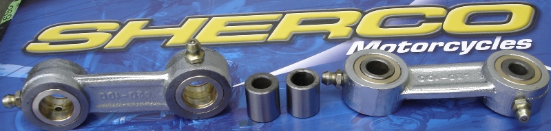

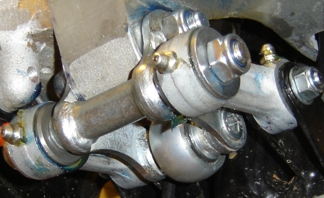

Find a good machinist, and have him make this for you. I had this on my Gas Gas and Sherco, but the machinist has moved. So I'm looking for a new machinist to make this for my Beta. It makes it easy to grease after every ride!
post-21248-0-47710700-1431707715_thumb.jpgpost-21248-0-23851100-1431707730_thumb.jpgpost-21248-0-03771200-1431707739_thumb.jpg
Top picture and second, left side, 96 Gaser, right side; original Sherco and 3rd pic is Sherco installed.
As you can see, I beat the Gas Gas ones until I destroyed the links themselves (rusty ones in picture)
I seem to recall someone on the internet selling these also for a lot of money, but can't remember where.
Watch the clearances on the front grease fittings. They can be hard to get at if you don't put them in the right spot.

Be sure to have the machinist use a good quality bushing material, my first set weren't hard enough and didn't last as long as I'd like. The inner bushings are the standard bushings and the bearing replacements were made to fit them.
Alternatively, I also buy the needle bearings from a bearing supplier, Eastern Bearings here in New England, for about half what Gas Gas and Sherco want.
I have to replace them in my Beta very soon, so I'll buy a set from the dealer, write down all the numbers and see what I can find elsewhere. Unfortunately, the inner bushings and seals are bike specific and I've never found cheap replacements.
I like to keep a spare pair of dog-bones greased up and ready to go so when I'm in a hurry, I just swap them out and clean and grease the other set in my leisure time. Until I get new grease-able ones anyhow.
If you don't have a spare pair of bolts that bolt the front of the dog-bones to the frame I suggest you invest in them. They're great bolts because they fit in the frame and I don't need two wrenches like the Gas Gas and Sherco I had, but I doubt you'll get them at the local hardware store if you break one.

Update ,
Found out that the NEEDLE BEARING # 46 was the main source of the play... upon inspection found some of the needles missing and the seal was broken letting lots of Dirt inside....
So, Im gonna order it asap....
Any f you have the CODE for search this bearing by its SIZE ??
Ill try to search it at the Bearing Shops before placing it for Order...
