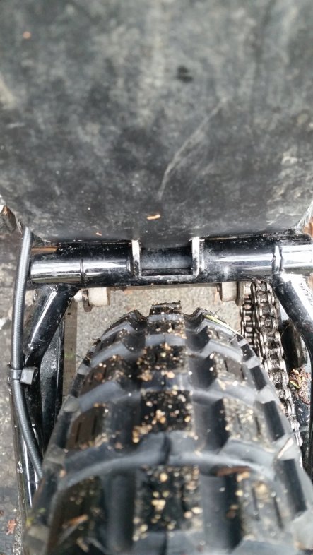

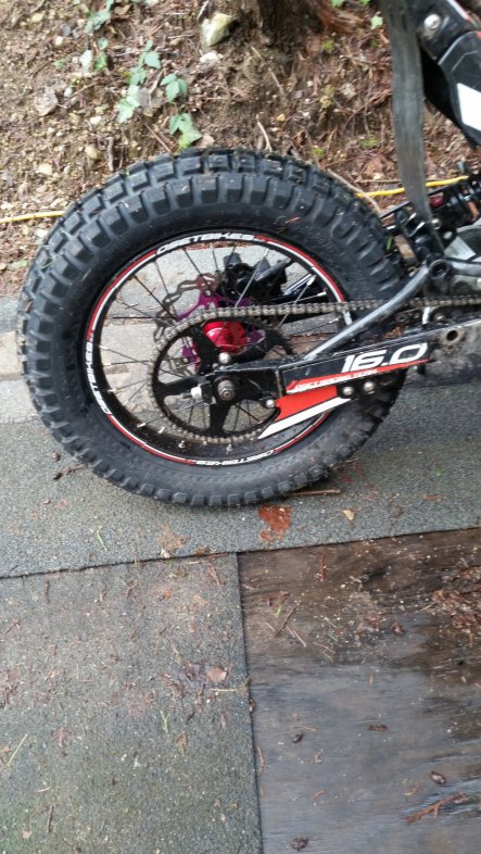

For years I kept coming back to this thread hoping for some new information! And out of extreme need I decided to experiment so I can let others know what they can do for their kid's 16 which greatly improves their riding.  Firstly, the info above is correct. Technically a 3.00x12 tire DOES fit.  Like all dirt bike tires, it does take a bit of work getting the new tire on so I suggest leaving them in the sun for a few hours to soften the compound and use a bit of soapy water for lubricant.  The OSET rims are not incredibly durable compared with a standard kids dirt or trials bike (say a Honda CRF70 or Beta 80).
End result:  I used a Shinko SR241 3.00x12 ($28 USD) and a Kenda 2.75-3.00x12 tube ($7 USD), running at 2-3 psi, all sourced from Rocky Mountain.  And its working amazingly!
