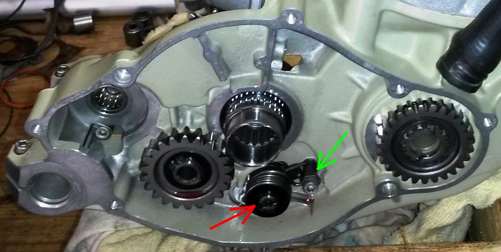

No Cabby, the top hat is on the right (there is a line joining the green bits to the red bits in that diagram).
Once you remove the clutch, you will see the top hat (red arrow below) which is held on with a circlip. After re-assembly, you have to adjust the eccentric bolt indicated with the green arrow below.
You might want to consult the Jim Snell "GasGas Pro Engine repair videos" videos at http://www.trialspartsusa.com/youtube.htmlto see how that is done.

I am slightly confused by that picture above.
I need to remove the clutch to see if tophat is broken but seems the tophat is actually at the gear lever side, is that right ??? cause that's how it looks in that picture.
No the top hat is on the clutch side. It connects to the opposite end of the shaft that the shift lever connects to. You can see the slot in the shaft that the pin that breaks slides into. I will try to video it tonight.

If you look at the line they just have it shifted to fit on the page it goes on the end of the shift shaft.

Yes because your not there yet. I did a really bad video but my boy Zippysgasgas hasn't told me the team password yet so we will do this with photos.
Without the cir-clip and the washer under that clip removed you can't see the problem. Here is what the top hat looks like with the washer that would go under the cir-clip looks like.
Now when you remove the clip and the washer you will see that the top hat shear pin is no longer one piece!

If you look closely at the picture the bar that goes from one side of the top hat to the other sits in the slot cut in the end of the shaft that it sits on. When the bar sheers off it still looks fine but it just turns in the top hat without turning the top hat ... at least that is what I think people are trying to say.

Righty, have the top hat off and if you guys are referring to the piece that goes across the middle, then its seems fine to me.

Hi Cabby,
Yes that top hat looks ok. My suggestion is to put that back on and check the adjustment of the little eccentric post that the springs sit on. Check out the Jim Snell videos in particular this one https://www.youtube.com/watch?v=A80n7zq80n8 and go to time 6:28 to see this actual adjustment.
That sets the center return point of the mechanism between each shift. If it's not right then the little cams in the shift drum won't drop into place for the next up-shift.
Also, you need to have the chain on the bike and spin the rear wheel while shifting (and either slip the clutch on or put some resistance on the clutch shaft). This is because the dogs on the gears don't usually line up until things start turning at different speeds.
Last time I had mine apart I was convinced it wouldn't shift the higher gears but once it was all together and I took it for a ride, it was shifting just fine. Testing on the bench is always difficult.
