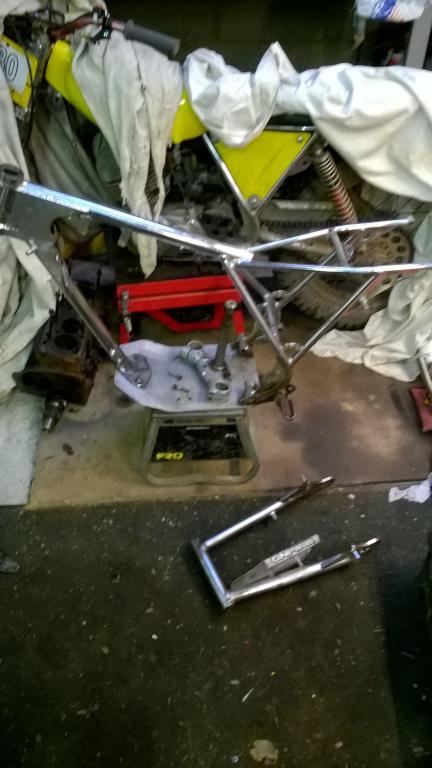

Here is the frame i have just picked up, i have just ordered new head bearings for it so will be slowly swapping parts onto this frame

  • Hello, I am probably wrong but I think those fork clamps/yokes look like the type fitted to the Beamish sidecars. If so the geometry may be slightly different to suit a sidecar. Hope this is helpful

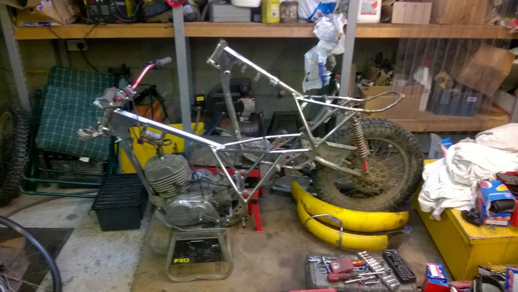

hello again, is the 2nd frame you have got made for the Black Engine ?
If it is are you intending to fit the Silver Engine in to it ?
I hope I am wrong but I have an idea the engine mounting points may be slightly different.
might be worth checking before you dismantle everything
The plan was to put my silver engine in the later frame, i haven't really looked into it but the mountain points look similar so was hoping it would be ok, failing that i will hold out for a black engine
Well this is how they stand so far, silver engine needs some spacers making up and longer mounting bolts and need to make some new front engine brackets, other than that im hoping it should be okpost-21311-0-99757400-1450645764_thumb.jpg

looking good, I am glad the engine fitted ok.
  • 2 weeks later...
Change of plans, will be going back to old frame and building that up instead, to much work is required to make everything fit later frame
