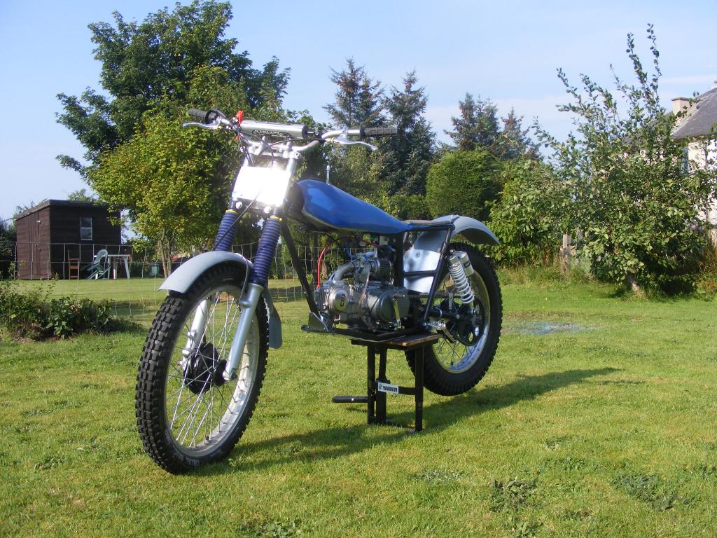

Recently finished building this bad boy  :rolleyes: post-10645-0-13668500-1443081587_thumb.jpg

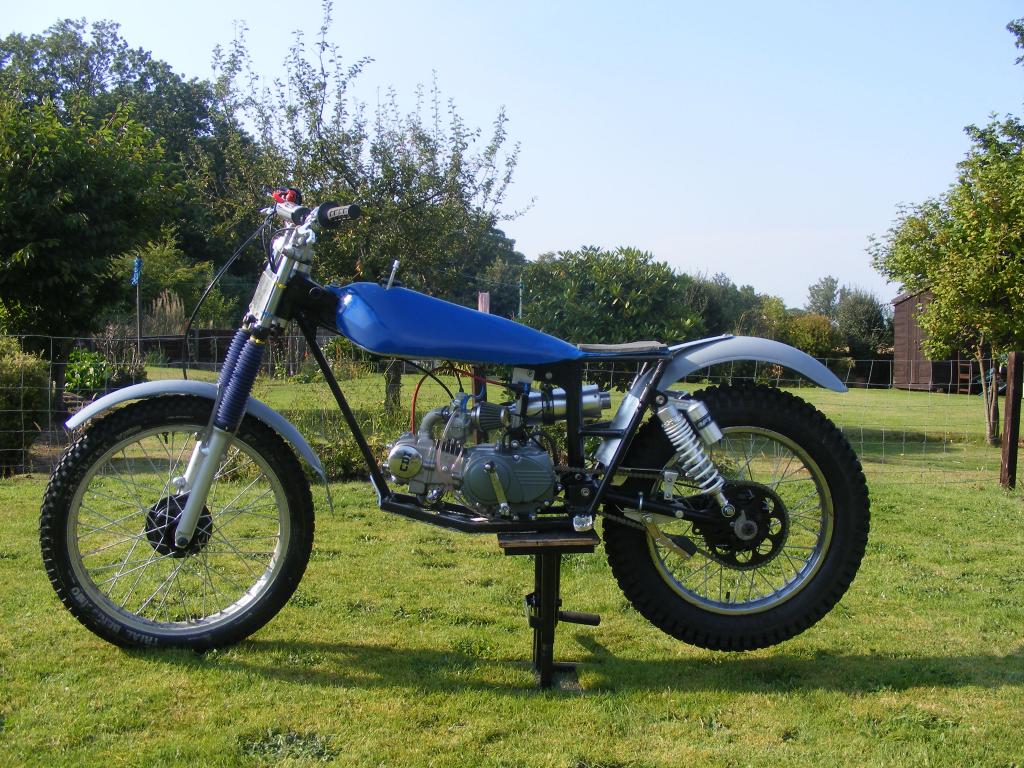

  • A few more photos of the bike

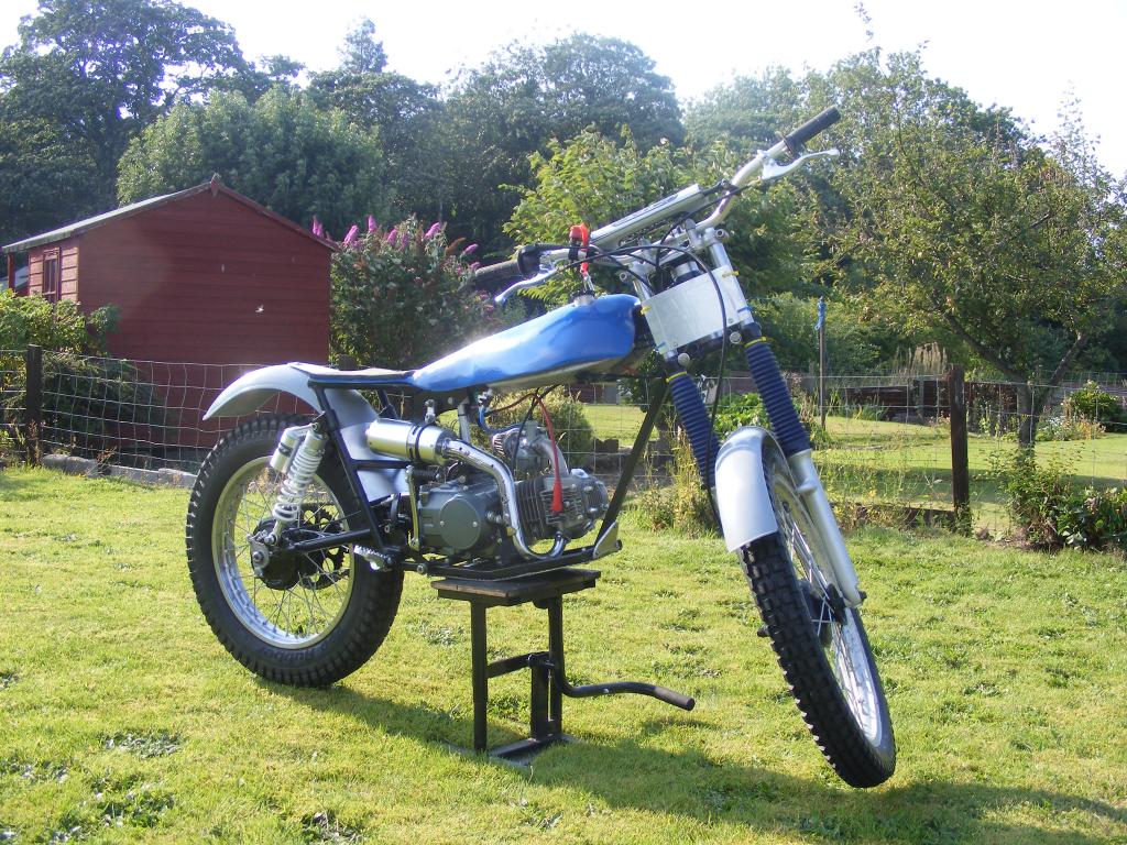

  • A wee change to Project 8x4,I stretched an old bantam frame and used the running gear   from the original project.It's a work in Progress cheers the noo Brian
  • The new and improved 8x4(photo courtesy of Jennifer Charlton Photography)   cheers the noo Brian
Aye it clears the frame,set the head angle at 70 degrees
Cheers the noo Brian
Hi Guy's.
Hi Brian,
I hope it was the "Mini Otter" project that gave you the Inspiration for the build?
I hope it rides as good as my little bike (second on the way) .
Good luck with it ,and secondly thanks for building it. and showing others a different  way , nice one fella.
Regards Charlie.
Hi Charlie it was indeed your "Mini Otter Project" that inspired me to build the wee bike,it took me 2 months from a drawing/sketch to finished machine.It is probably one of the most rewarding things that I have done(all work carried out by myself).Looking forward to a run out on it on Sunday.
PS.it didn't break the bank :-) :-) :-) :-)

Wee update finished my first trial today on the 8x4,missed out 2 sections(big hill climb/doon hill).The wee bike rode well,a couple of things to do,gave a couple of experienced riders a go on the bike and they told me the bike is fine and well capable perfect for club trials :-) .
A big thank you to the Lothian Trials club for an enjoyable day.

A wee update,I finished my second trial today on project 8x4 ,before the trial I lowered the gearing which transformed the wee bike(13 tooth front sprocket) ,front forks bottomed out a couple of times on a section dropping of a banking into a burn.Big hill between sections but the wee bike managed it(think I found the limits of the wee bike and wouldn't push it much further).Also it crashes well.Got about a month to fettle the bike till the next trial.
