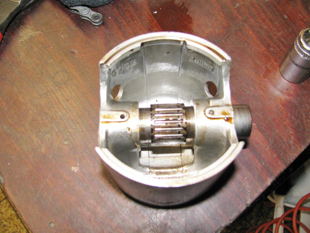

This is how the piston pin bearing was mounted.
Some one forgot the two spacers apparently:

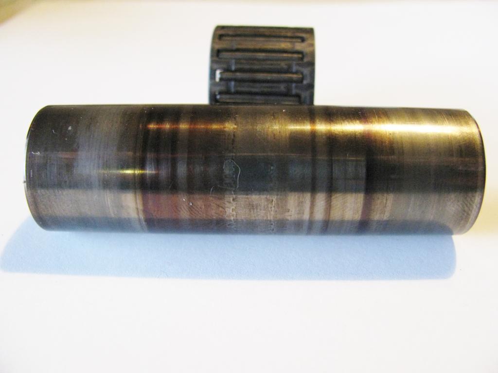

Maybe that explains the  blue heat marks on the pin:

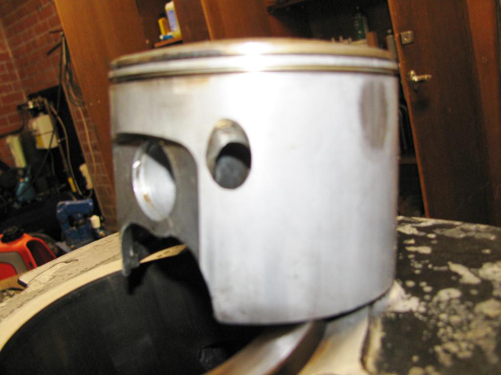

Although the piston - cilinder clearance is at the maximum, the rings were still doing their job, hardly any blow-by deposit on the piston.
Yes there should be 2 spacers on the MAHLE piston the new typ don't have them they don't fit so you have a 30mm small end bearing.

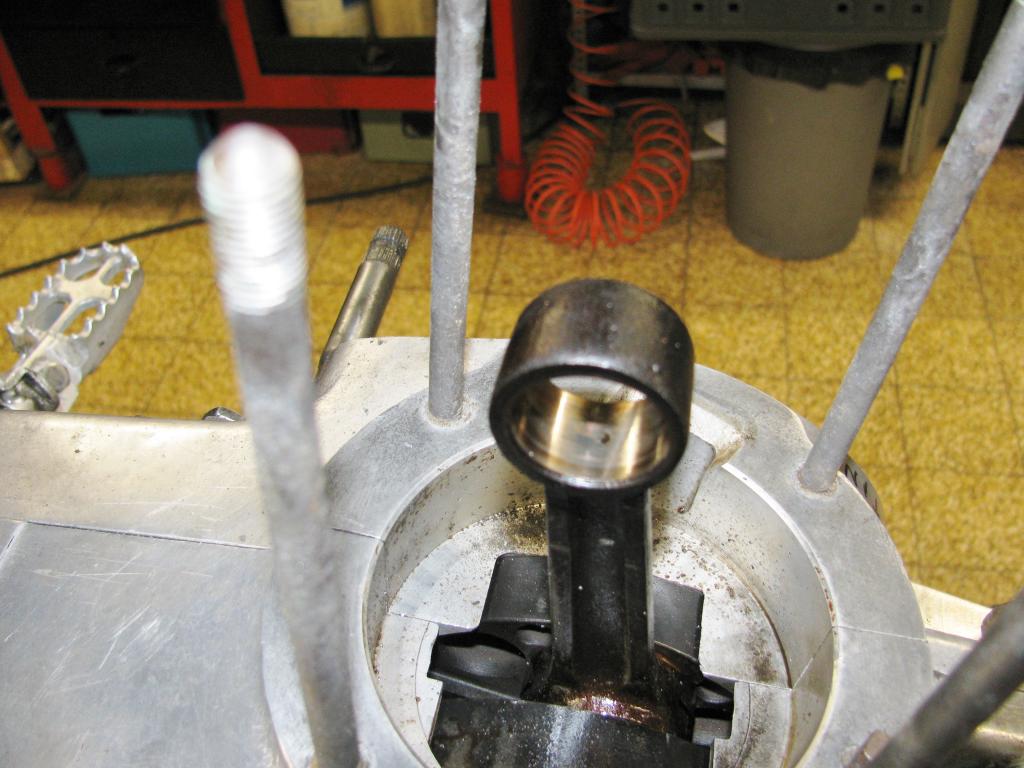

How does the lower con-rod bearing work. If you turn the crank with the con-rod the movement should be nice without any roughness or resistance, runnig freely but thight.
Piston pin looks very used.

When I turn the crank with with the con-rod it runs without roughness or resistance, but I would say it runs very loose, although I can't feel much radial play.
The axial clearance between the con rod and crank is 0.6mm, but I don't know how much it should be.
I think the pin looks very used (looks like it has been running hot) because the bearing was missing the two spacers, so the bearing could move sideways, resulting in the fact that sometimes only about half of the needle bearing was carrying the load.
The inside bearing race of the con-rod (at the small end) has the same discoloration as the piston pin and clear wear marks at the bottom (might also be from the fact that some times only half of the bearing was taking the load.
To be on the safe side, I'm going to replace the con-rod.
