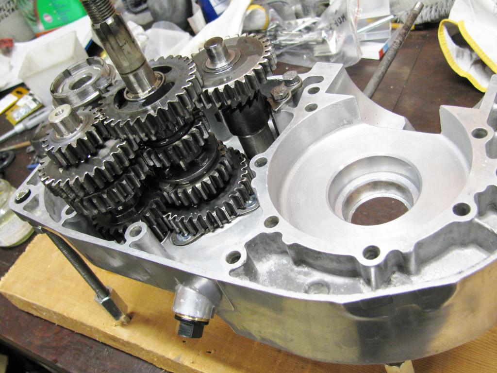

  • The engine cases are split and all in all it doesn't look to bad for a 40 year old bike One crank and one gearbox bearing is damaged/worn.   Santa came early this year      Home made case spl

Some damage by the kick start mechanism
The middle gear on the left axle seems to have to much play.
The vid is nice I thing the third bearing had some debris inside.
Anyway I would try to replace damaged engine parts, especially to the kickstarter and to the gearbox, a broken gear can cause some damage.  (I would replace whenever possible the pair of gears).

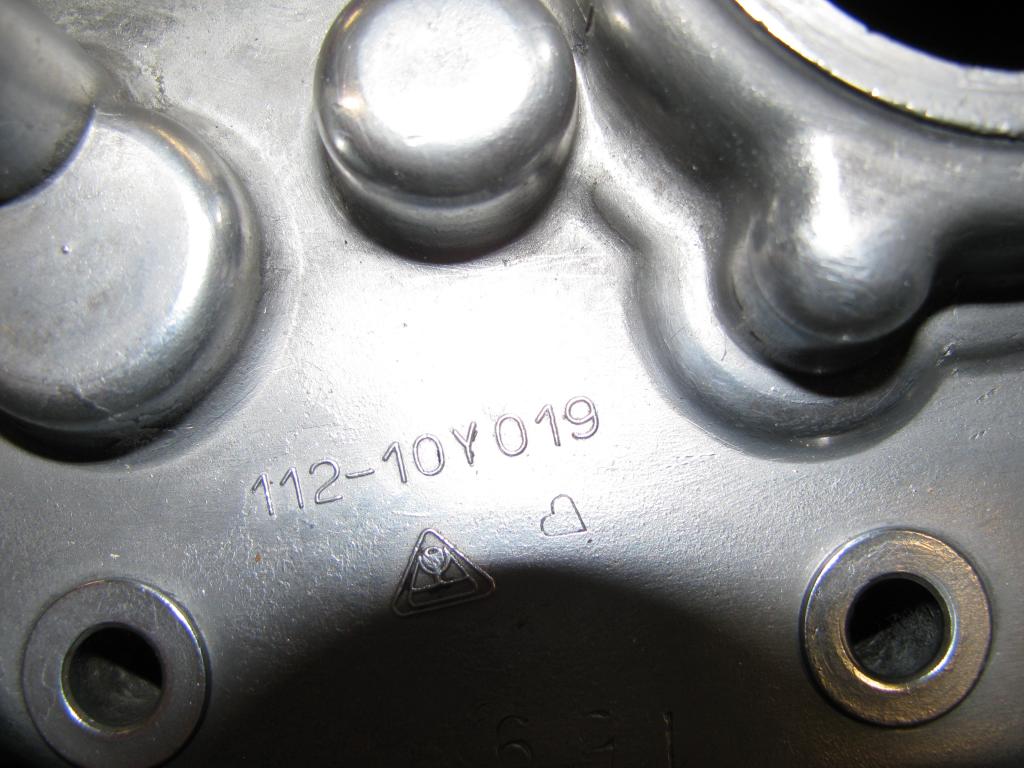

Now isn't that lovely, they stamped a little hart in the case.

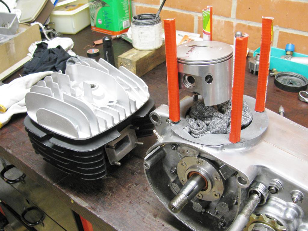

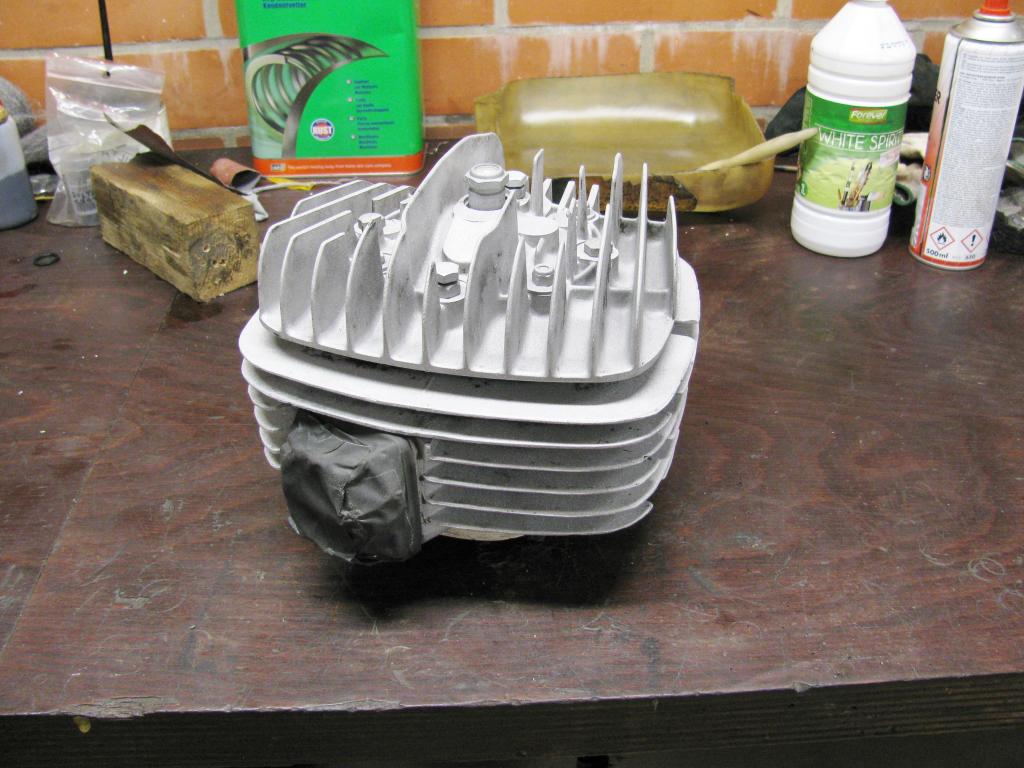

Cylinder and head ready for painting, which in the meantime has been done. The cylinder is at the shop for a re bore and the crank shaft for a new con rod.

Although I thought that the free spinning gear on the layshaft had too much play, it wasn't as bad as I thought.
Thanks to InMotion I got a  brand new, about 40 year old  :rolleyes:   shaft and gear.
Thanks to a manual, and the simple lay out of the Bultaco engine, the rebuild is coming along nicely. Crank and cylinder are expected back from the shop any day now...

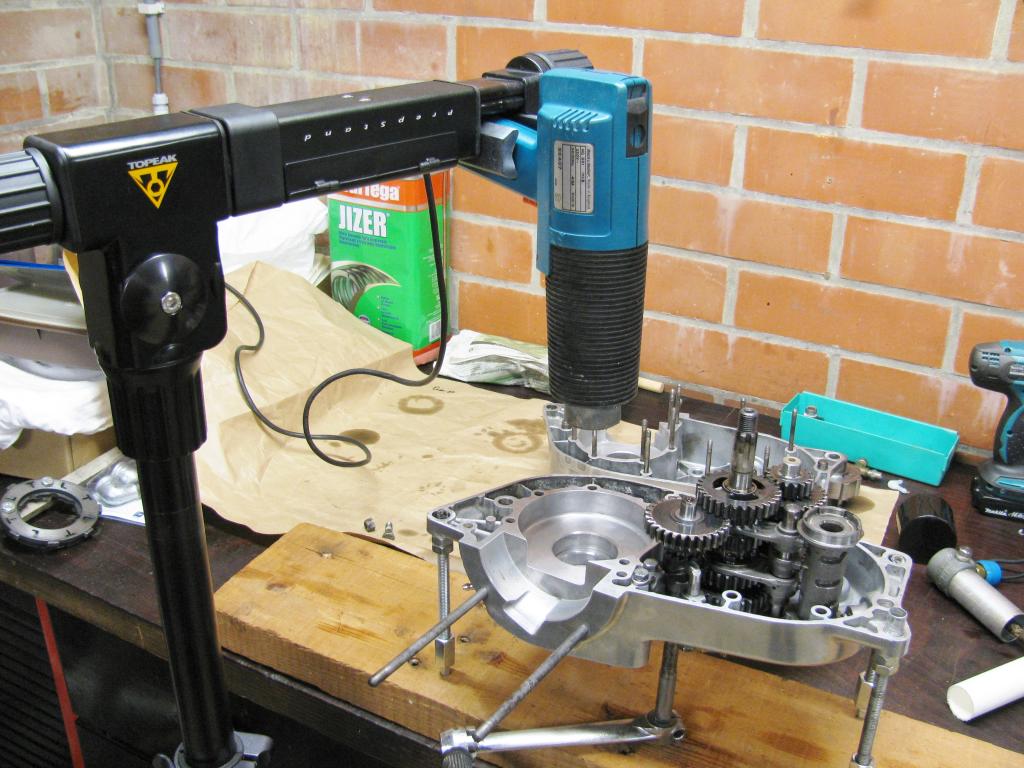

Heating up the engine case to insert the crankshaft:

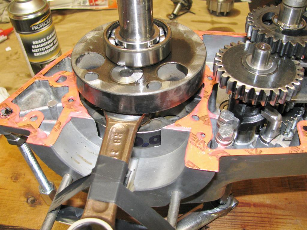

Putting Loctite 510 on the gasket, just to be sure.
