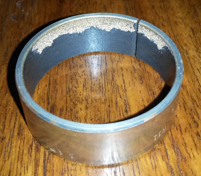

Unlike the Tech forks, the problem with the Showa forks is not really the seals.  It is the teflon coating coming away from the top fork bushes and bits of it getting caught under the seal causing it to leak.  Eventually you will have metal to metal contact with the fork tube which won't be good.
This is what a faulty bush looks like (and that's not wear and tear):
Andat are these Showa forks? I am still having problems with Teflon stripping off the upper fork guide bushes. Factory say there is no problem with Showa forks

Hi Chris, A little harsh, I have seen the correspondence between my dealer and the factory in regard to the bush problem. The factory is simply saying that there is no problem with the Showa forks in general and no problem with the bushes in particular.
Thanks for posting the photo, that is exactly how both my bushes were on my Repsol when first stripped. It is clear that there is an issue with the Showa forks and that it did not exist on the pre 2014 machines, the factory attitude is bloody annoying.

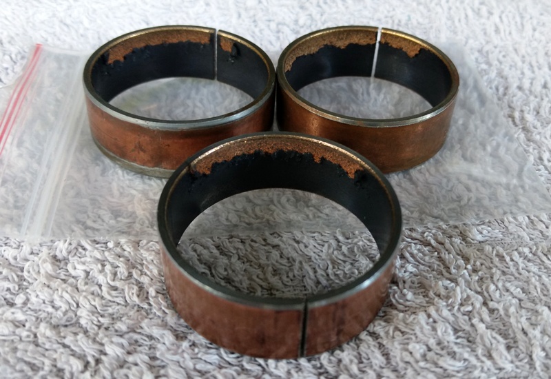

I was wondering if anyone has found a suitable replacement top bush for the Showa 39mm forks.  I am gathering quite a collection of faulty bushes as each replacement one I buy fails in the same manner (teflon pealing off and getting under the seal).  The last one I bought lasted just one month (3 rides) and I'm getting quite annoyed about having to replace the bush and seal this often.
I was hoping to find an aftermarket replacement or something off another bike.  The dealer here has contacted the factory about this a number of times and they continue to deny the problem and just say it's not a warranty issue.  I don't want warranty, I just want a bush that lasts like it should.
Some of my bushes:
Some of my bushes:
Hi Chris, Exactly the same as my collection of bushes. I can add that after the first couple of failures I started orienting the bushes with the split to the front of fork leg, so that I could tell the position that the Teflon was peeling from. In my case it is the lower, rear section of the bushes. This eliminates any suggestion of the forks being out of line due to not centering the front axle. (In my case as noted in earlier post I have assembled front axle and fork bridge with the fork legs in full compressed position ) I too am convinced that it is a problem with the coating process because the damage does not extend vertically through the bush as would be caused by any fork tube damage. My dealer has sought advice from the factory but received no response, of the failures that I know of with the Showa forks all occurred after a short period from new and have continued following rebuilds, I have not had this on any of my previous Showa units.

I don't think the damage is mechanical from topping out, there are no marks on the edge of the bushing to indicate contact.
