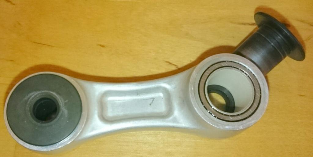

If you want to have less maintenence at your linkage throw out this useless needle bearings and put slide bearings inside. As a spacer you have to use a bushing. I took inner rings for needle bearings on mine. The inner rings are fitted with a special loctite glue.
I use this modification for about 6 months and the linkage is still close to free of play. I had about 5 mm vertical play at the rear wheel axle on the nearly new bike before I done this mod.
Wow that looks interesting. What are the slide bearings made of?
It's steel coated with bronze and on top PTFE (out- to inside). There are different coatings and materials. There are even durable bearings completely made of special kind of plastic, see igus.com

Hi, I already tested just these bronze bearing bushes. They are very soft and deform to easy. It works but the mod with hard steel inner rings as distance bush does way better. And you don't need sealings with slide bearings. Perhaps they last a little longer but depending on your use of the bike you have to renew the slide bearings once or twice a year for 1-2 bugs each.
