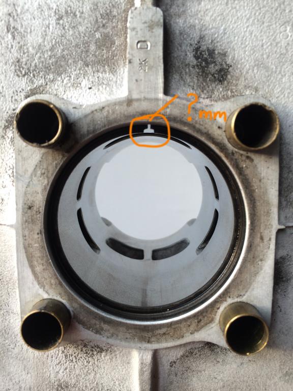

hi boys, does anybody now what the factory size of the gap of piston ring in fantic fm350 (trial 200) 156 ccm?
is it 0,1-0,3 mm?

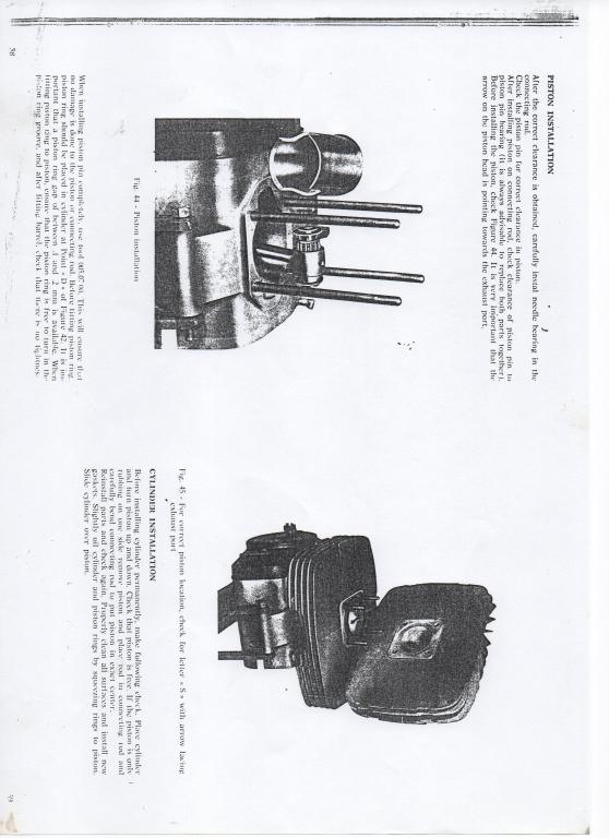

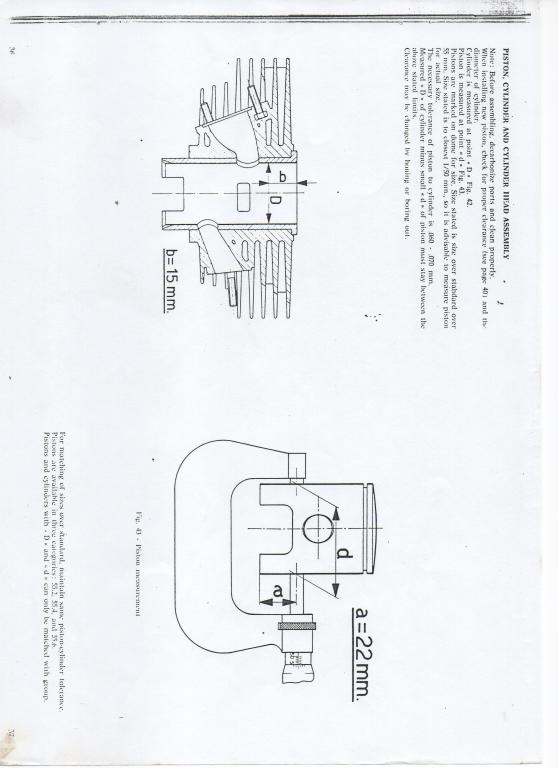

This is an extract from an old copied manual I got a few years ago. looking at the bottom of page 38 though, that's a heck of a gap.
Hope it helps though.

Hi szymon
Just sent them. Still think that's a wide gap, so might be worth getting a second opinion.
Paul
thank's for the pics. no info about the piston ring gap. i think its +/- 0,2 mm but not sure. at my set is like a ONE mm!
