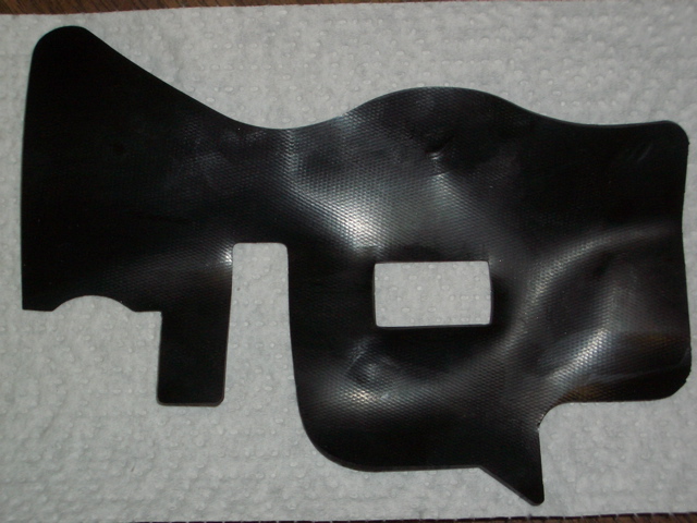

If you want to stop water into air intake ,I get a piece of thin neoprene and make a cut out for the intake that tucks under the lip ,the sheet i made covers right up to rear plastic trim,tucks in under guard lip and goes down each side till it shows out under rear guard,trim off at that ,and extend the neoprene right down to the tank mount screw hole i have found this stops any water ,although it is not mean't to be a submarine.This way water splashes are deflected and run down the inside of the guard etc.Hope this helps.
You could also try using the 2005 model splash shield that seals around the shock and prevents water travelling up the gap between the inner side faces of the airbox and exhaust.
Bear in mind that the engine still needs to breathe and only very deep river crossings will test the standard setup.
Sometimes the harder you make it for the water to get into the area surrounding area, also makes it harder for any water to drain away and blow right on through.
