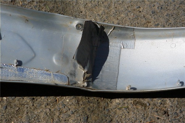

When washing the sherco It's possible to get water in the airbox were the fender runs along side the airbox, this is what I do to cure the problem.
I use door seal a thin foam strip the is sticky on one side, I also add contact glue to give a more permanent seal.

Yep - good idea, I've been pasting kitchen sealant down the side, but as I use the zip tie method to save my mudguard (and regularly make use of it), it's not been going so well. I'll have to give the draught excluder a try.
From another angle, also they put a plastic boot over the intake rubber on the 03 and 04 models, to stop mud and water splashing up from the front, this makes it a pain to try and line it all up when installing the carb and airbox, I, Sheeet can, it and just put a piece of duct tape over the same place.

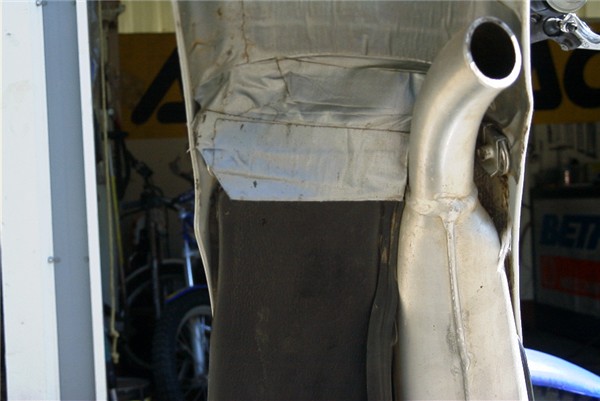

And on the bike you can see how it covers and keep the crap from getting inbetween the box and the fender.
Plenty of other ways to skin a cat, this is what works for me with good results, NO WATER OR DIRT IN MY AIR-BOX :huh:

I find that a lot of the "splash" comes from the right hand side of the exhaust. (When looking from the rear) Try putting a smal piece of foamin that part. The draught excluder looks agood idea though.
