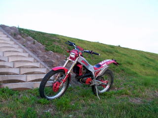

I bought a beta zero of my dads mate
When I took the plastics of I discovered they was no brake fluid (front and back), no water, the air filter box was thick with mud. I took of the top when I cleaned my bike, but I think I got water down the air tube into the carb. I shoved a few rags into the tube and got the water out but I think they will still be dirt and dust in the carb. What should I do? Also I oiled the filter and it looks ok. The other thing if it had no water it properly has no gearbox oil. Can any 1 tell me how I can top it up and, list a few other things that it properly needs. Tires are set at perfect p.s.i and are brand new

i cant see any plugs iv had a good luck about . also how much would it cost to do my carb in a bike shop
for your OIL DRAIN PLUG ITS UNDER THE BASH PLATE just look for the hole in the plate,under the bike, the oil filler is on the kick start side large washer shape with allen key fitting check for right quantities on www.the trialcompany.co.uk go into previous models
thanks guys iv found it it was a large allen key scre on the top and a small flat head screwdriver screw on the bottem
but i still dont kno what oil to put in it

put PJ1 clutch tuner 75W IN THE GEAR BOX,give john lampkin a ring or look on his web for the ammount you need to put in
