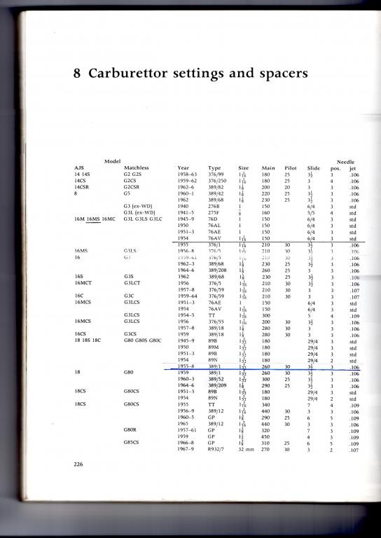

Some carb settings attached, Monobloc first used on and#39;55 models (after Aug and#39;54), prior to that they were side mount float chambers.
The and#39;55 settings should be near enough, looking at the jet sizes I think I would experiment with something a bit bigger.
I understand Mono & Concentric sizes are the same.
Dick.
No attachment! Give me an old bike any day!
I'll try again, if it doesn't work my book quotes 210 main & 30 pilot.
Dick.
