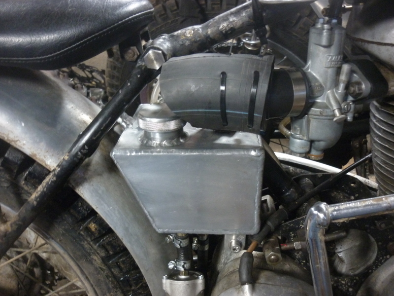

This is the tank I made recently for my AJS,its not perfect by any means - but its tucked in,doesn't leak and holds enough oil for my needs.(About 1.5 ltrs)Its made from,(Secondhand) 2mm ally sheet with weld on fittings from Merlin Motorsport.The on/off tap came from Screwfix. :o  Just below on the return line is an oil filter which is a fine mesh type.This is came from Ebay and was listed for a pit bike,but perfect for my needs.Room inside for a small magnet too...

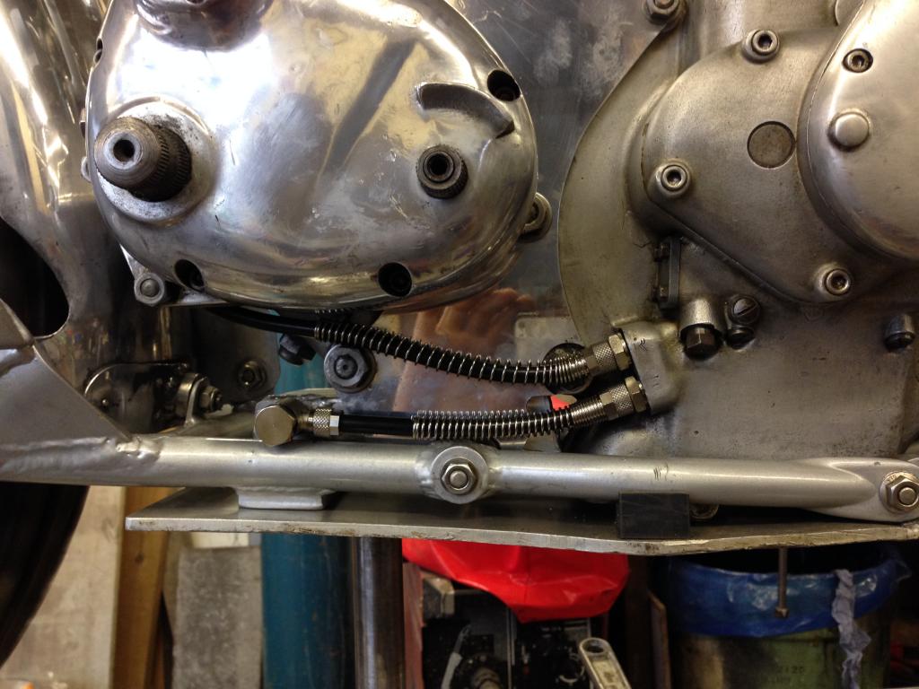

This tank goes inbetween the engine and the gearbox and goes underneath the gear box.tight fit ! post-16813-0-28843900-1457128575_thumb.jpegpost-16813-0-58760900-1457128616_thumb.jpeg
So who makes that one?
Home made,cap from eBay,8mm poly pipe and fittings from a local suppliers,the tank is made from 2mm alloy.
My gearbox is locked in one place,so I could make the tank as tight as possible.just thought it would give you

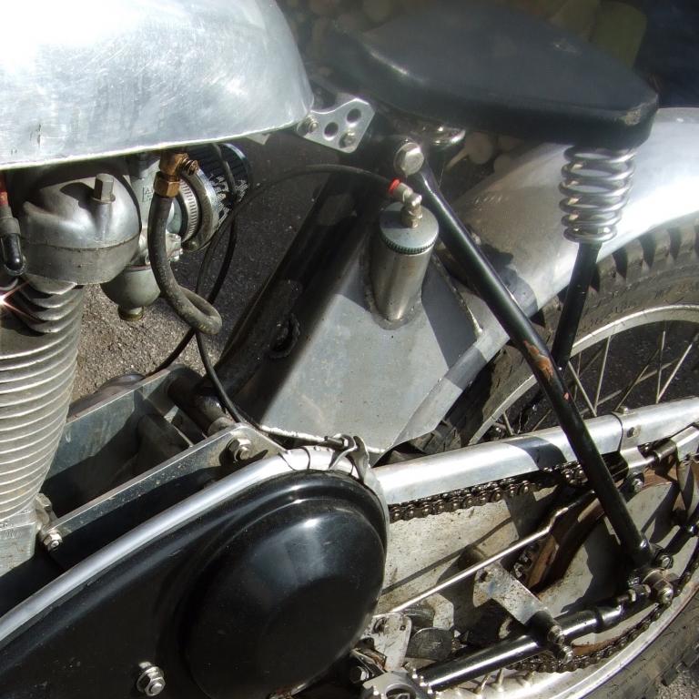

A few ideas.heres another tank fitted in between the rear mud guard and the frame on a rigid.post-16813-0-05079800-1457301782_thumb.jpeg
