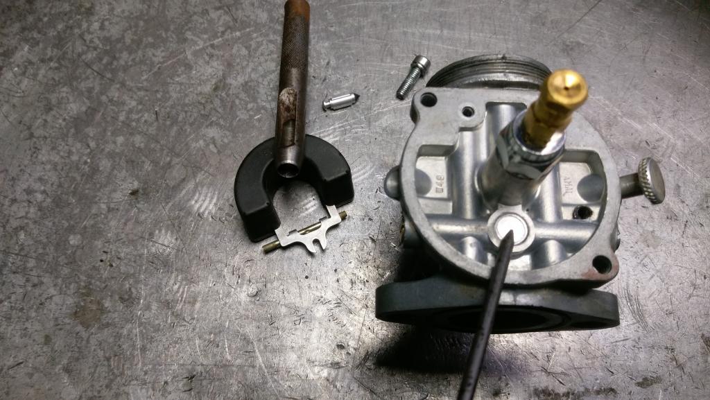

The carb will then have a strip and clean,I'll make notes of jet and slide numbers etc, and post them up. I'll also post up a pic of one of the best mods that need doing on a Concentric Mk1. I can't say its the perfect set up,but it works on my bike,and those daft enough to have a go on it seem to think its OK.

OK, took it apart tonight, main jet is a 170, hard anodised slide 2 1/2,needle is 622/124 and the air filter is a well oiled foam one.( I think the oiled foam aids very low rpm pickup.)So the body is a 626 R300.The attached pic shows the mod I was shown. The blunt scriber is pointing to the soft alloy core plug that often leaks from new.The last 3 carbs I've checked have all leaked, just spray a little liquid over the plug and block two of the three pilot holes.GENTLY blow a bit of compressed air into the remaining hole and watch the bubbles come out around the edge.BE CAREFUL DOING THIS. In the pic there is a gasket paper punch with a sharp edgeleaning on the float,stand the carb body upside down and use a punch like this to swage the plug out to make it seal.If you look carefully around the plug you will see a faint ring where I've done this.
Doing this makes the carb more accurate when running on the idle circuit and therefore easier to keep in tune,good mod that costs nothing to do.Notice how clean the carb stays on Aspen fuel...
