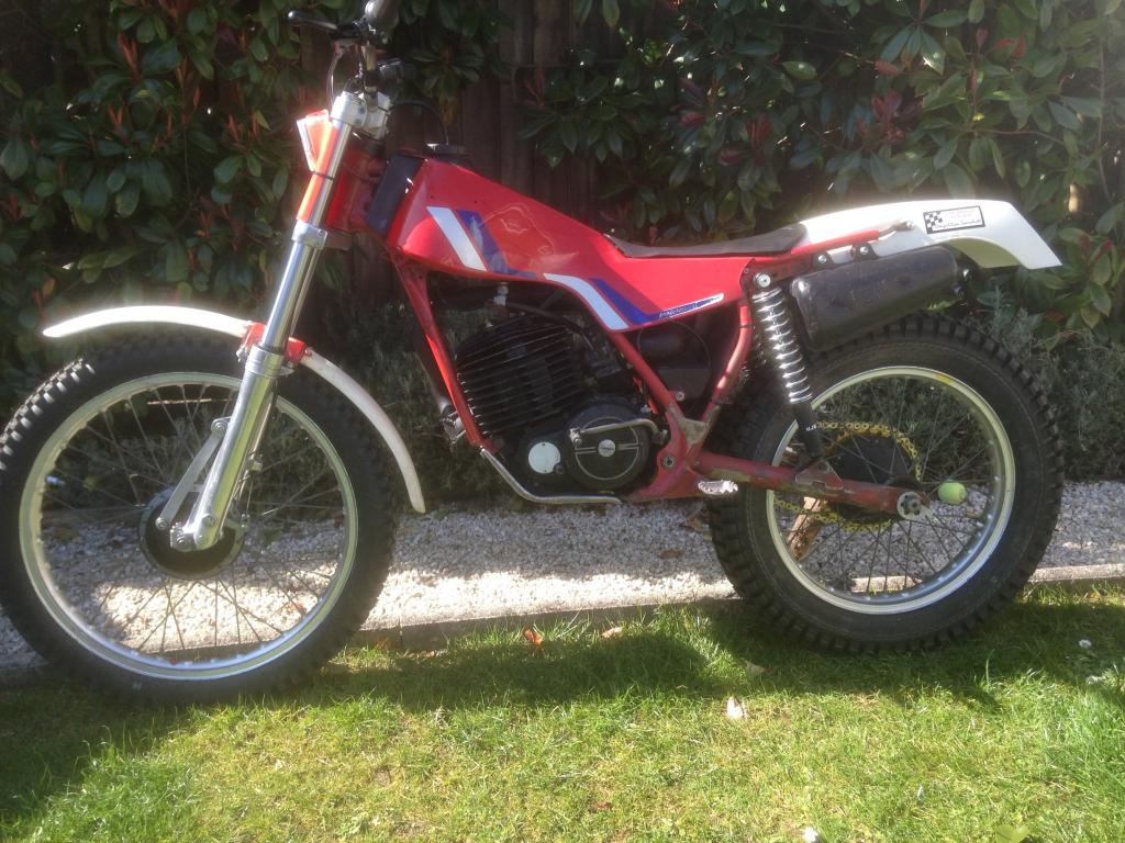

My 300 Made up from spares in the shed from a few fantic's i have collected over the years  not a looker a Rider
