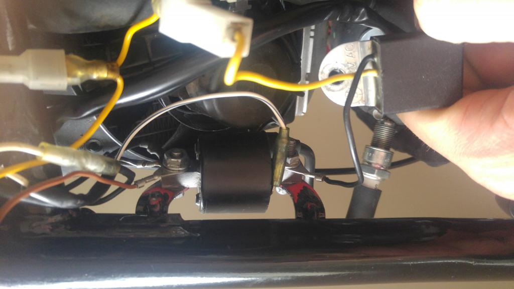

Does this look ok? Is there a place that the regulator needs to be mounted? Just sanded the paint off and its still no spark.post-22415-0-52155800-1462985079_thumb.jpg
On my '14 the voltage regulator is mounted under the the right ride (if you were sitting on the bike) of the coil on the bottom where the rest of those wires are.   That tab on the voltage regulator is actually a heat sink and not a ground so not being mounted would not affect your lack of spark.  Mounting it will just help dissipate heat and keep it from getting knocked around.
As Eazyste pointed out, both those holes in the frame for the coil need to have the power coating removed so that you have good contact with the coil and with the other wires mounted there.
