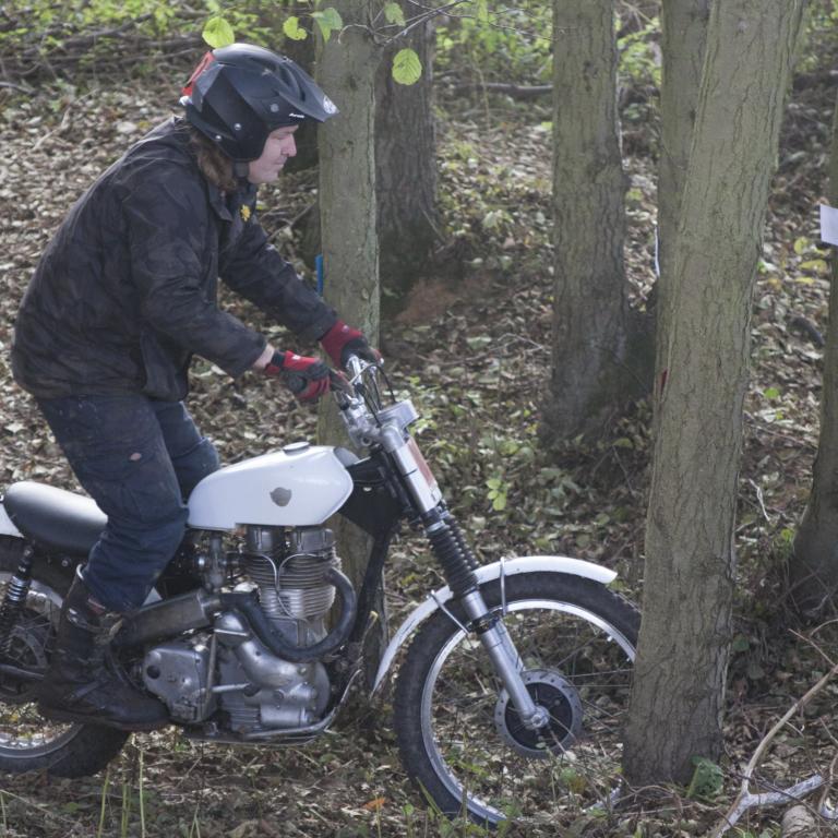

I hated your section, was on the red Enfield, and lost my ONLY mark all day there !!! James WIllaims bike is very standard Indian type parts and he is in with a good chance of being overall winner !

Ahh yes James...that boy can certainly ride! My brit bike loving mate did say that his bike looked very old school.

PS James lost a few on section 13....clean on first lap then dropped a few on second and third.
Lucklly i rode the Easy route toady and your section was OK , Should have added use an earlier 6 inch front brake (later Indians bikes have a 7 inch twin leading show brake. James bike has Indian style hubs, frame,gearbox. so virtually none of teh real trick bits , although i think it has crusader fork lowers .
