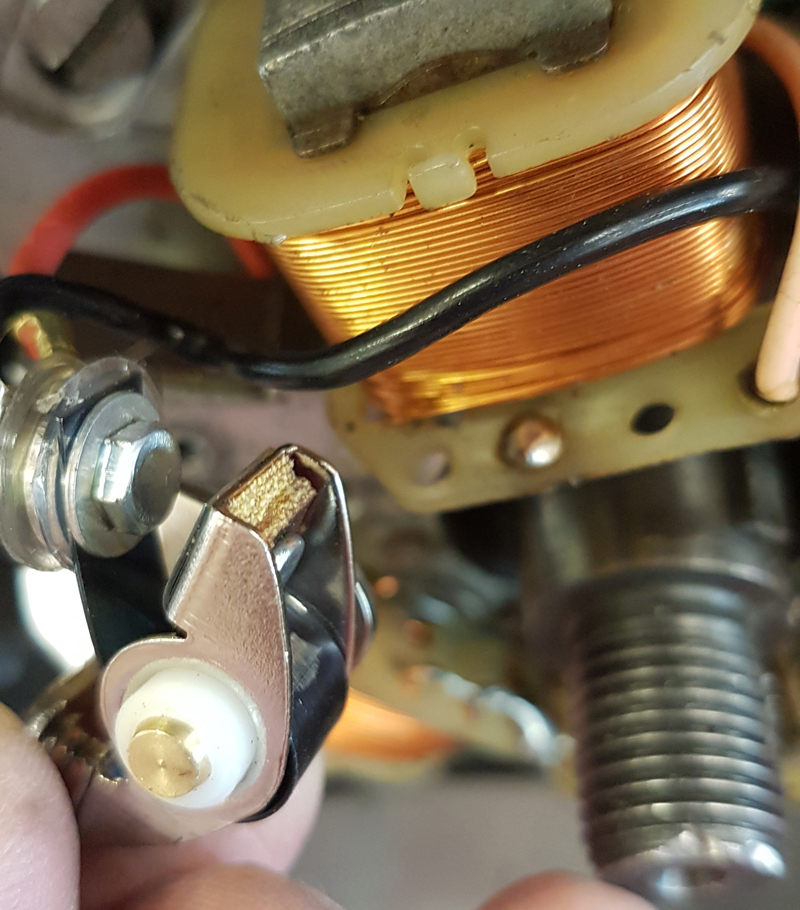

I've been restoring my TR77 for 18 months after it sat in bits for 16 years. On completion it had a huge fat blue spark and started brilliantly many many times whilst I was finishing it off. Got it road registered and went for a test ride. After 12 miles of the engine running smooth as... it suddenly stopped. Problem, no spark at all.
So, is there a guide anywhere of what to check, what values to expect etc? I My Clymer manual tells me that it is an electronic ignition model, but the new points and condensor I fitted suggests otherwise! I have a good meter, and understand the ignition system, but have no data or values to check against. Yes I have checked the plug!
Any ideas or suggestions welcomed.

Hi all - thanks for all of the replies - especially so to dadof2 as that was just the information I was after and I was reluctant to strip the relevant bits in my freezing cold garage without knowing some values. :-)

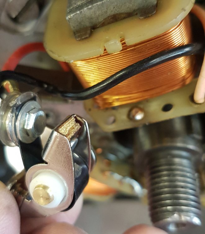

Anyway, to cut a long story short, it was an easy problem to see in the end - the end of my (new) points had snapped off! new ones ordered.... but worried that the same might happen...
