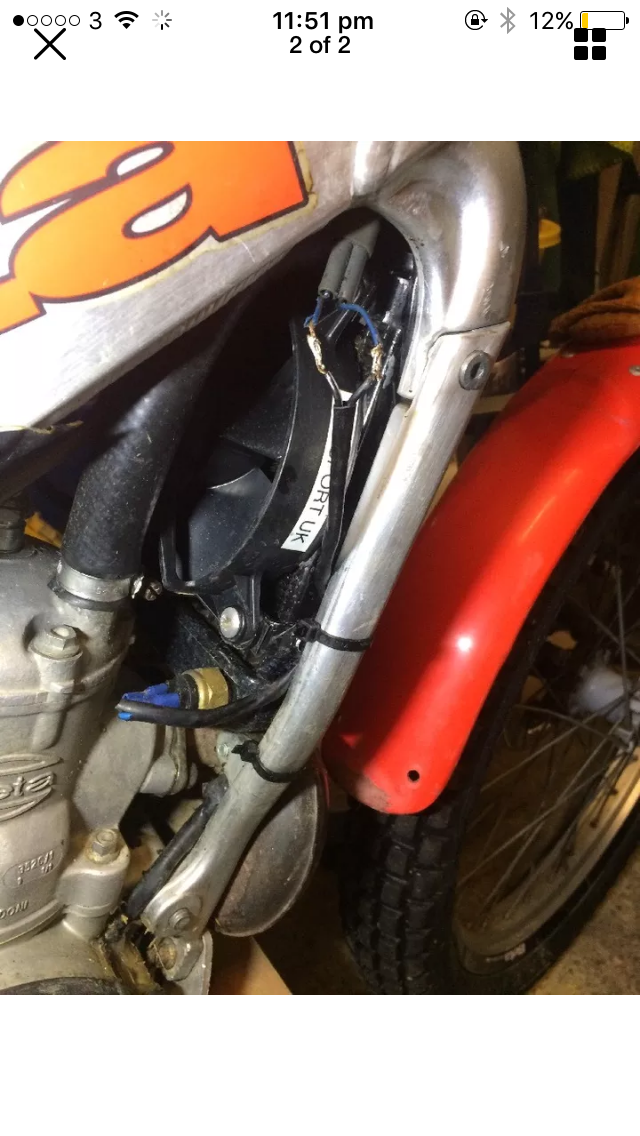

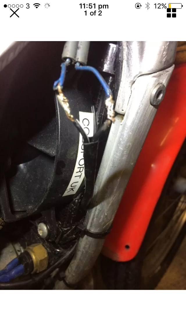

Hi guys. I've got a 2005 rev 3 and the guy before me ripped out the electrics for lighting. I'm trying to re-enstate the front light, how do I get power for it? Do I take a live from the fan and negative from the kill? I found where he removed something from the fan wire (guessing it's for the light) looked at wiring diagram and couldnt really work it out. And Is there upgrade for the standard light? Here are some pics of the fan wiring

Tie your light to the yellow wire from the from the stator. This will power the light and ground it to the ground at the triple clamp. I added an aftermarket switch with an Led light which works fine but I only use my Rev for trail use. Hope this helps.
