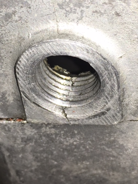

Following the last trail I did, I now unfortunately have a crack between the sump plug hole and the case edge.
I assume the only way to fix this will be to strip the engine and get it welded ?!
With this in mind what parts at a bare minimum will I require ( seals, gaskets, bearing etc...)

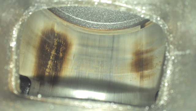

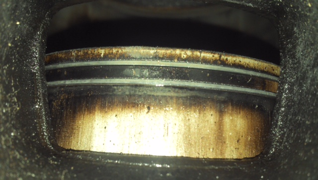

These are photos of the cracked sump and of the  piston and bore looking through the exhaust port.
if its no longer rideabl i d have that out and stripped down for a full rebuild or replace with another last i saw Adrian at TOR had taken in a bulk supply of MAR's and associated stuff
