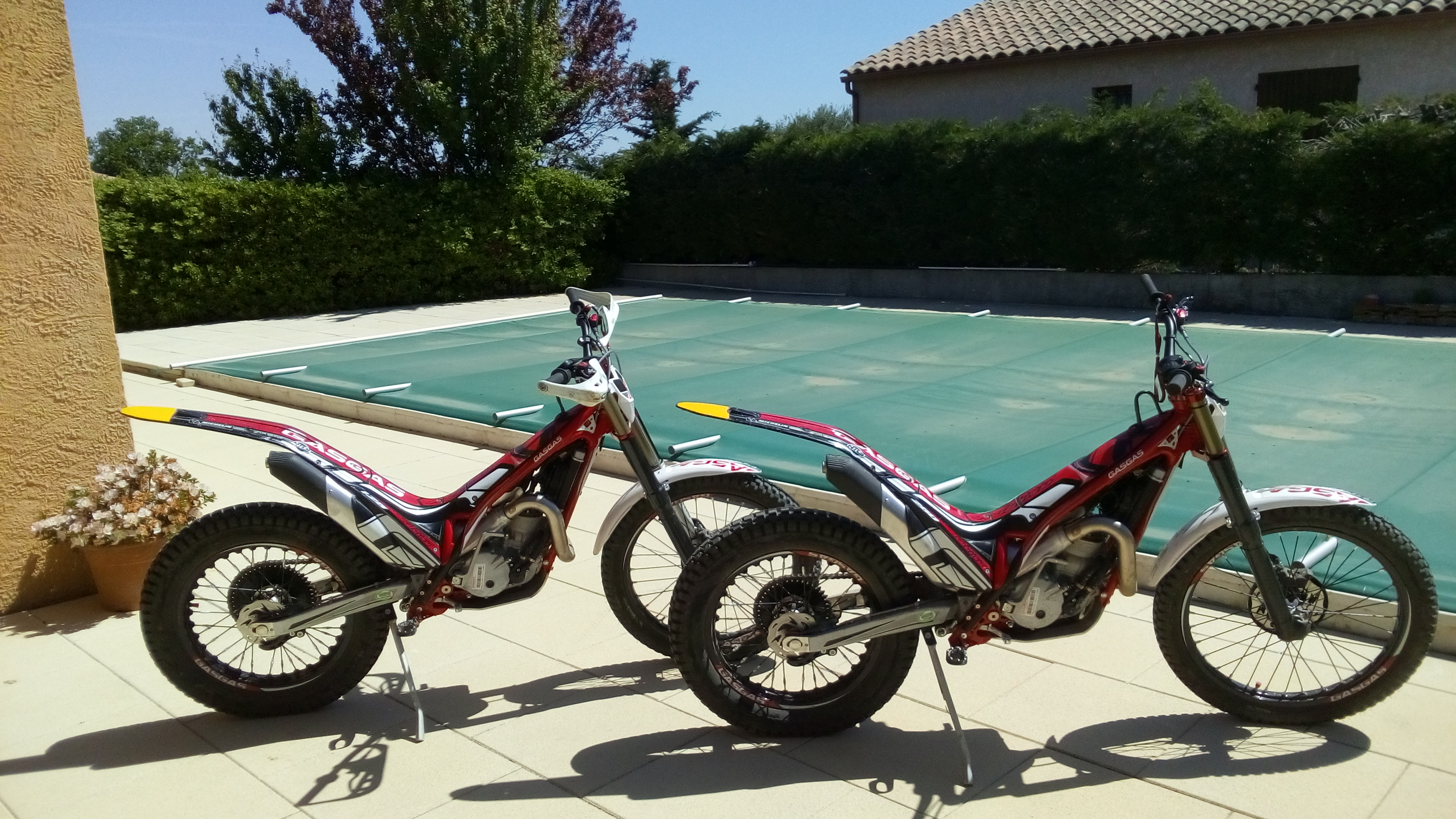

Just become proud owners of 2018 (yes!) gassers a 250 and a 125.  I appreciate I.ll have to wait for Glen to get back from sunny Spain but am looking for general experiences from others. I should say we have less than 2 hours on the clock so my impressions are probably a bit premature.
1) The reworked clutch is dragging (even adjusted right to the extreme/ the hydraulic element is fine)   is this a funtion of the OEM filled oil?
2) The steering is sweet..don.t know what they changed in detail but yep great.
3) Both the bikes feel a bit "flighty" or nervous  which with the clutch drag makes them harder to ride than my  old bike (280 2015)
3a) They are both "hard" to start  as if it could be a sticky float needle;.. definitly not first kick (yes I know there is a knack plenty of practice with that)
4 My gut feeling is a weak spark, if I set the carburation (only using air screw and idle) to run smooth and sweet it makes the bike more nervous than if I set it to run lumpy/rich on tickover.
clearly the motors are  tight ( reccomended 8 hours of running in) so it may simply be this. Being  a parsimonious pensioner I cant help bemoaning that we are going to take the edge off two new tyres whilst struggling with draggy clutches and tight motors before I can make a proper assesment. I can say they.re not straight from the box /PDI easyplan to get on and ride well.

PS Monday riding session was good, probably got used to the bikes now ....still feel I,m being rushed re stalling but  the motors are still tight which is good. All adjustments need to be very precise (10 deg. on air screw changes it completely). Steering is great, you would need a 3 way shock if you.re good enough I should fit a fat git spring ( Ihave to use the damping to "help" the spring which compromises/slows the extension when rock hopping or tring to deplace le arriere)...if my legs were 40 years younger it would be no problem but then I would have all the problems of a 25 year old...money,job,career, taxes,family, etc.. Clutch is OK ..plenty of feel but still drags a tiny bit ...hope imminent oil change will help that.  I have yet to benifit from the racing headlight but lights are compulsory here as is registration and insurance so just as soon as the C.O. C. arrives we.ll be "in business".
Just reminded myself that what I started out trying to find out is eg.; are there "fat spark" plugs available?   What G.box oil is best? (these are first new Gassers I.ve had in the last 20 years).
Just a note, We now done 6 hrs running in  found a few build faults ...chain tensioner sticking, a cylinder head bolt on the 125 was ready to fall out (noticed leak of coolant)  other comments lots of small adjustments to personalize the bikes had to set air mix a tad towards rich and pick up the tickover as the bike was rushing me or trying to stall..now that the clutch and I are getting along it,s fine although Janet is still having problems ( the motor is much crisper/cleaner than her 2014 model, probably due to the kehin carb). So far so good just hope Torrot can come up with the correct COC,s to get reg.d and insured before the Cantal.
