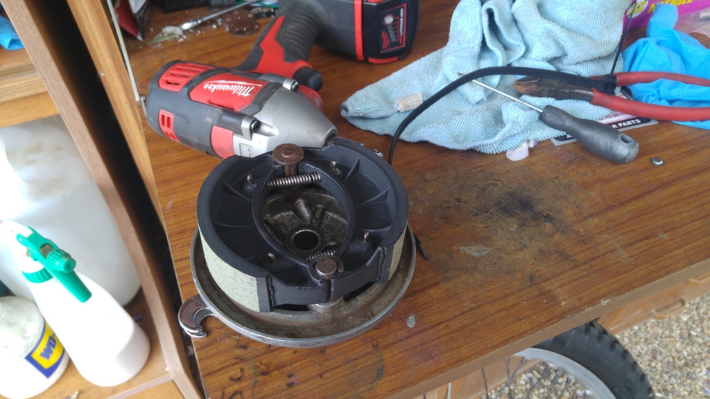

Cota 247 with creaky 'n spongy front brake: solved
As found:huh:
Well it never stops with old bikes does it.
My front brake cable is now too short by about an inch...been cut back in the past I guess?:rolleyes:
....new shoes on the back plate
A nice thick layer of material there....should make lots of contact with the drum when bedded in.:D

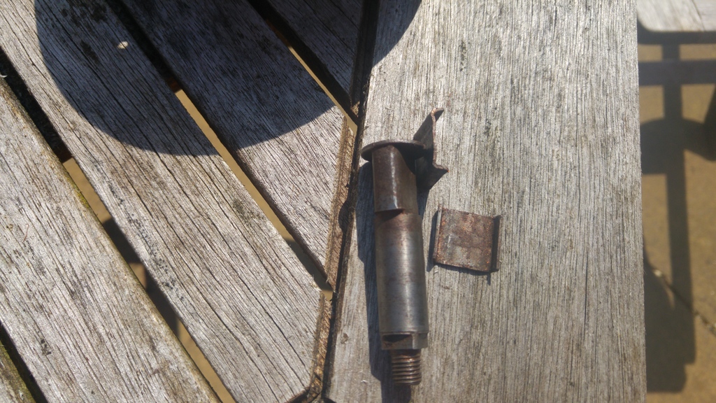

Yes having a square drive for the arm is a bit of a weakness at times like that
On 2017-5-12 at 8:24 PM, iconic558 said:
As found:huh:
I wouldn't be too hard on the previous owner - packing out the shoes was standard practice in the old days, especially where the cam did not have a splined fitting.
I sometimes pack out the shoes at the pivot ends when the linings wear down a bit. On some bikes, it is easier to do that than packing out the camshaft ends.
