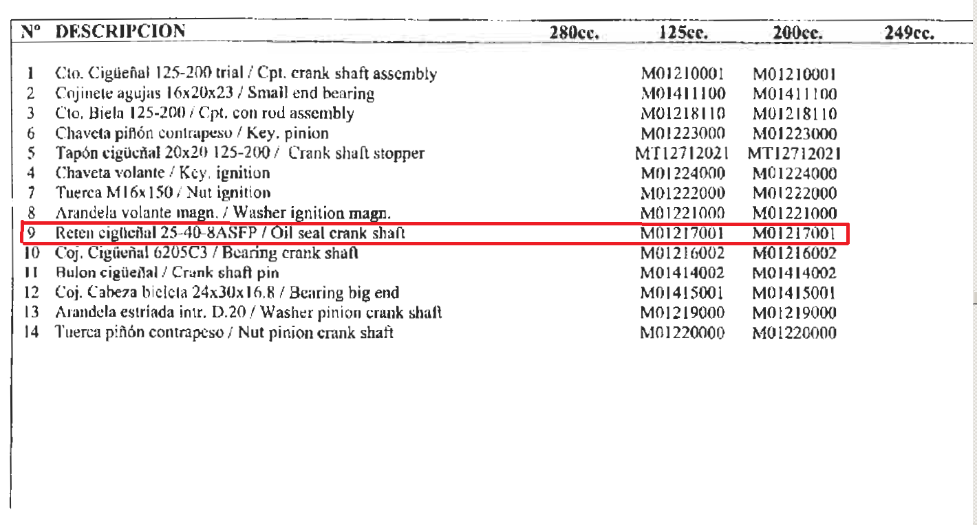

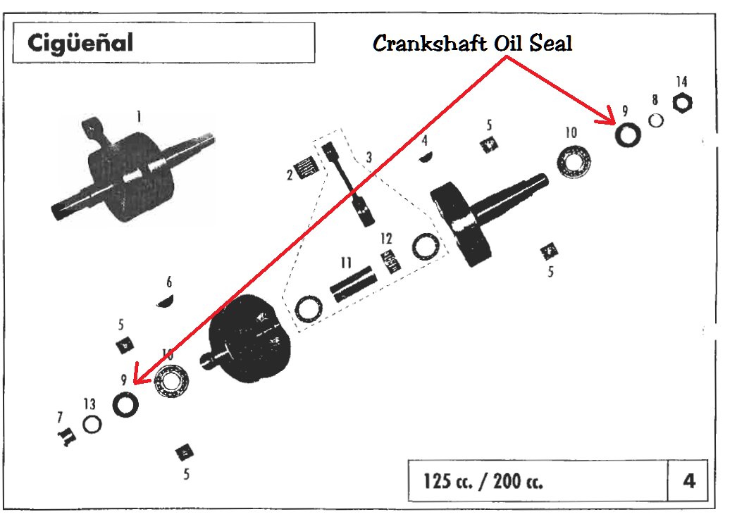

1 I take it that there are two oil seals on the crankshaft. One on the clutch side and one on the gearbox side.
 Are these oilseals the same, I have had a look in the parts pictures and I think the part number is,MT12944200. can someone confirm this.
2 As the bike is a bit old, are there any other oilseal that are the same. Also possibly cheaper.

I should check your rear silencer first, drill the rivets out and check the packing is not saturated with oil because there looks like a lot of smoke from the rear silencer joint also.and running it with the choke on won't help.Oil Seal part no M1217001 size 25x40x8

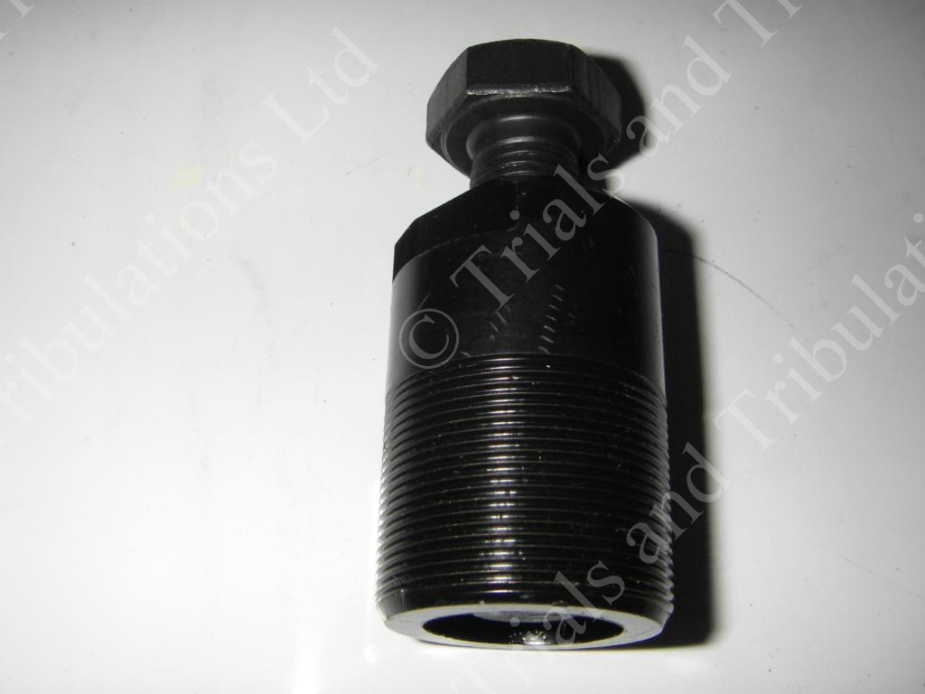

Flywheel Puller Gas-Gas Pro & earlier JT,JTR & TX
Part Number   BUZZETTIGG
Hope the puller is ok! here is a photo.
