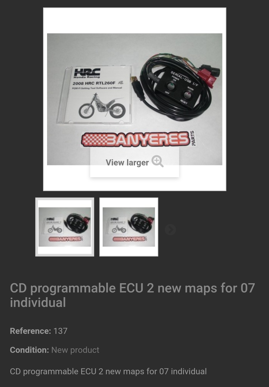

I have purchased the HRC Screenshot_20180108-211701_01.jpg 16400NN4315 twin map throttle body, but need the software to upload maps to it does anybody know if you can download it online.
Also is there anywhere with base maps you can download?

theres no where on line you can download the software from.
The software comes with the cable. it is shown in the picture so you should get it with the cable
Its not as straight forward to use but once you have used it a few times its straight forward.
Been tweaking maps for a while now
What a wally I am! I've just realised that the 16400NN4315 TB that I have ordered is a single map TB so I need the single map Software after I just paid £20 for dual map software. Bloody idiot

I have the 2010 RTL software. I've only used it for dual-map ECUs, but I think it can be set to work for single-map ECUs by selecting "05 RTL" under the "Model" menu-bar option. If you have everything else, might want to try that first.
