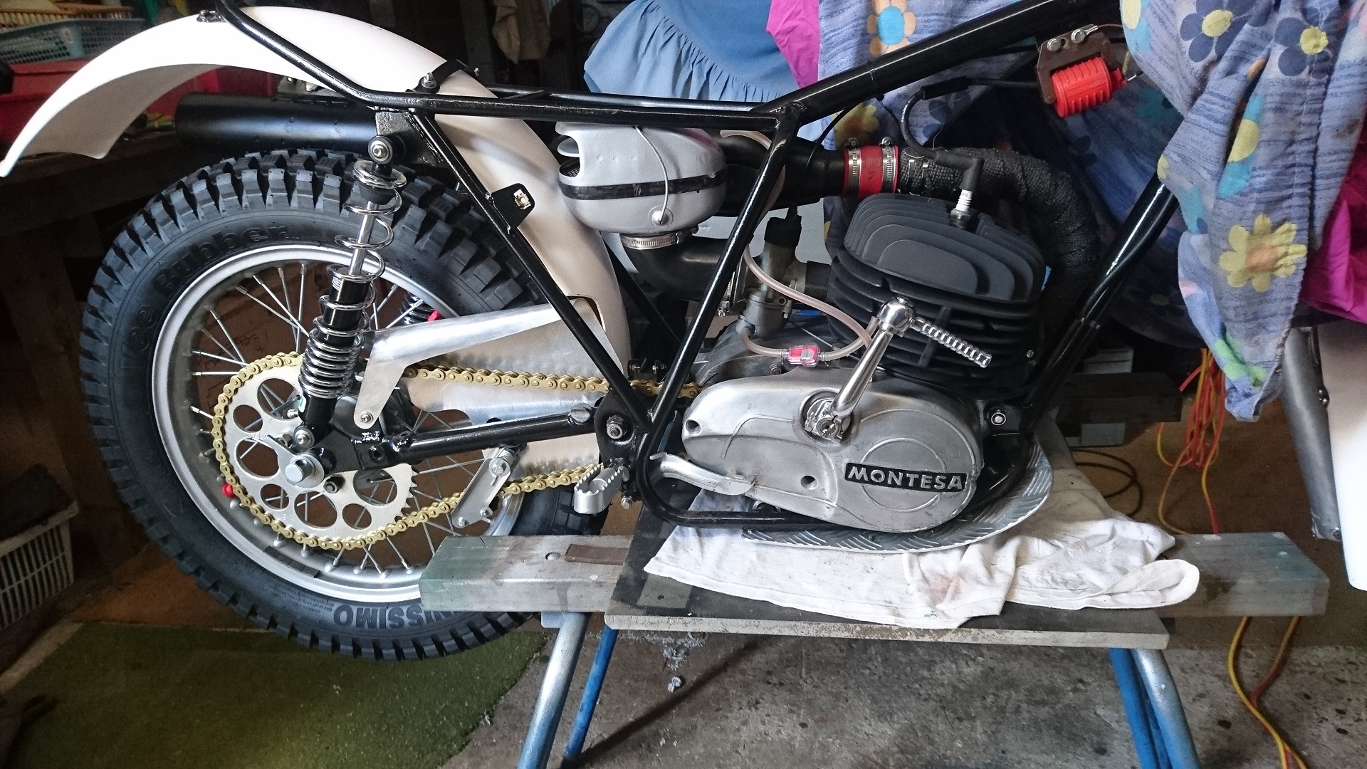

You do mean 11 o'clock, not 1 o'clock? The position in keychange's photo looks correct and wouldn't damage the casing

Here's a picture of the nicely re-chromed kickstart now in place and working fine and theoretically that's the last of the mechanical bits. Started on fibreglass repairs to the tank/seat unit, already got the 2k paint for it and first lit of fibreglass applied. Need to get some primer filler for the little ripples/scratches next.
