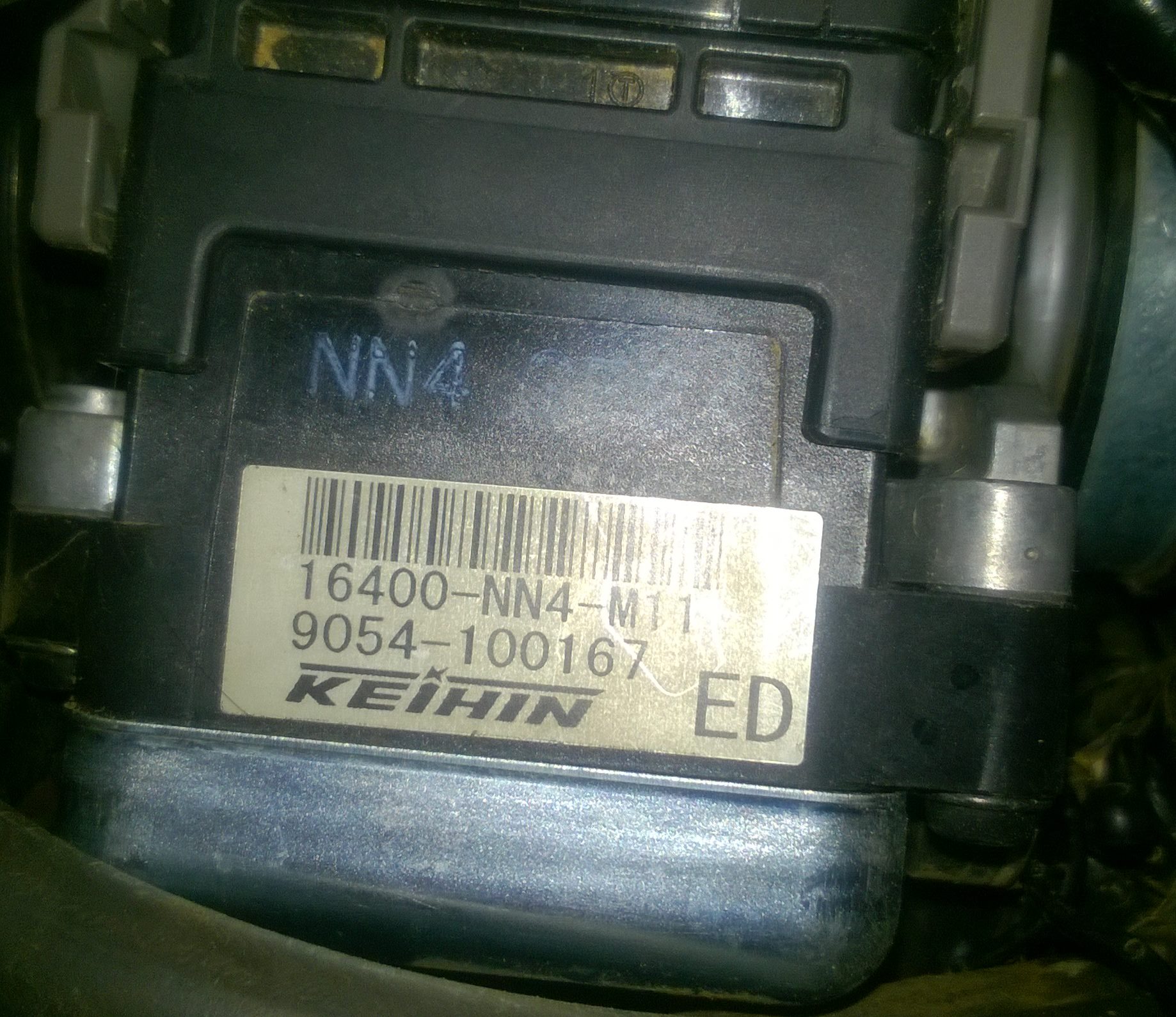

This is my ECU the number wich is printed on in "NN4 G24"

4 hours ago, hc-hardy said:
This is my ECU ...
The P.N. is 16400-NN4-M11, so that's the standard TB/ECU for ED/2ED street versions. It has a Mode 2 map (green/white wire connected to green ground wire) that's used when the O2 sensor, catalytic converter, and intake / exhaust restrictions are on the bike. Its Mode 1 map (green/white wire NOT connected to green ground wire) is used when the catalytic converter and O2 sensor headpipe is replaced with "race" headpipe and the intake / exhaust restrictions are removed. Map switches are not normally used with this TB/ECU. The wiring is changed (green/white removed from 4-pin connector) to put the TB/ECU in the "full power" map when all the street version (ED/2ED) restriction is removed. Here's a link to Full Power Version 2017 instructions. Look at pages 4 & 5, they show pulling the green/white (map selection) wire from the 4-pin connector to use the "full power" map on the 16400-NN4-M11 TB/ECU.
If you can get your friend with the 2018 bike to pull the fender, you can see if it has the 16400-NN4-L31 TB/ECU. That's a two-map "race" TB/ECU that comes on 3ED/4ED racing version bikes, and it has dry and wet terrain maps (see your Owners Manual, page 1-9). I suspect the 2018 bike is a racing version 3ED/4ED, and the difference in feel is the 16400-NN4-L31 TB/ECU. The 16400-NN4-L31 TB/ECU should be available from Honda OEM parts suppliers like KFM.
Edited by sportsawyer
