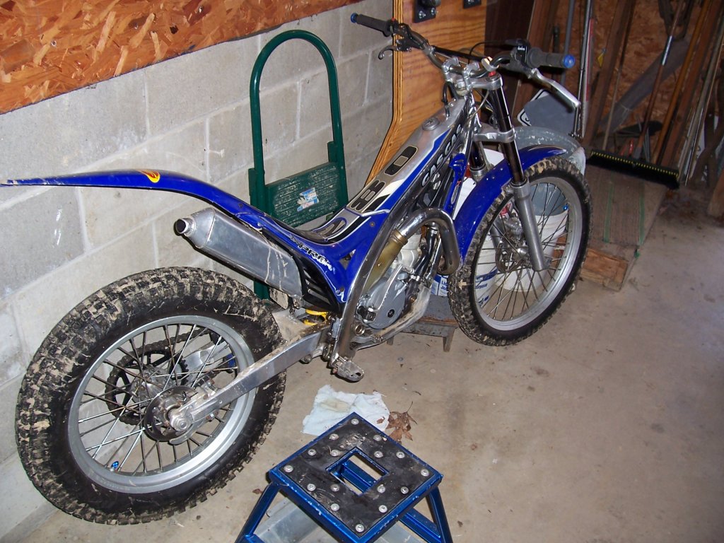

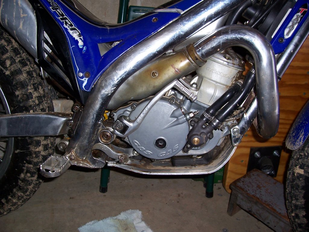

Here is a couple pics of the bike.  When I search on the year and model I get all sorts of images and don't know what to trust.  It has "pro" on decals on it but that could have been added by someone.
