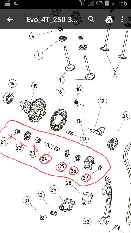

Hi guys: :D... Today while I was returning from a ride in the woods I stopped to do ..... .... "a prostatic discharge" .... Unfortunately when I went to resume the bike I noticed that .... SHE HAD THE SAME IDEA .... just put in motion lost water from the gasket HEAD-CYLINDER right side ...... exactly under the pump impeller casing . Lose only with the engine running and only at the minimum .... if I give gas stops losing .... I think it is excessive wear of the oil / water seal + pump impeller shaft. The leakage of water comes out with a good probability from the spy hole that allows precisely the water no longer held by the seal to escape and do not go to contaminate the oil. Well ....: fl ^ -g .... ..... since I have largely spent the 360 hours on this bike I think that how to say "there may be" .... Question: You think you can replace - impeller shaft - water / oil seals just disassembling the impeller cover ??? I have a doubt about something in particular or .... when I turn the spindle shaft .... there is no risk that the gear falls down into the carter .....: bho: bho ???

I believe I am due for a water pump seal replacement. Perhaps the shaft should be replaced at the same time. I could not discern if the water pump shaft can be removed without the gear driving it being disturbed. It appears that the engine needs to be at least pivoted down to remove the cam cover, and probably that would be the safer way (?) but who has done it ‘in sutu’ and just removed/replaced the shaft and seals?

When I had a small amount come out of the ‘drip hole’ I looked into replacing the water pump.  (The drip has not happened again, so I have not replaced it yet).
the manual says to replace it at some 60 hours, but I assume that is under extreme competition use and I doubt any ‘normal’ user does maintainence at those recommended intervals.
I believe the best way is to remove the radiator and side supports, remove skid plate and all but the rear engine mount, remove exhaust. Loosen carb jubilee clamp and tilt the engine down.  Then you can remove the top head cover and have access to the gear that drive the water pump.  Do you have the service manual?

I was able to replace the water pump shaft and seals on my 2009 4t just by carefully unscrewing the shaft (24) from the gear (22). The gear will not fall into the engine. I used an adjustable "Crescent" wrench to grip the flat on the shaft, much better than the weak special Beta tool. Take care removing the seals, you do not want to damage the aluminium bores. Grease the seals and shaft before installing the new shaft. I used a set of long, narrow, needle nose pliers to hold the gear up enough to engage the threads of the gear and shaft.
Of course, the engine will have to be dropped down-,remove exhaust pipe,separate carburettor from air cleaner, let the engine  hang only on the swing arm bolt. Lock the crankshaft at TDC on compression stroke with the locking bolt, first remove it's copper crush washer. Remove the valve cover.  Loosen the water pump shaft from it's gear, do not remove the shaft yet. Remove the cam chain adjuster. Remove the cam sprocket from the cam, then remove it from the chain. Tie a string or wire to the chain and lower it into the engine, the chain will stay on the crankshaft's sprocket. Slide the ball bearing (14) from the camshaft, then remove the camshaft. You can now unscrew the water pump shaft by stopping the gear from rotating with a straight bladed screw driver. Since I'm writing this from memory it would be best to consult the 4t Shop Manual that's available online. Take your time, I would allow about 6 hours to clean the bike and complete the work for the first time. Good luck.
