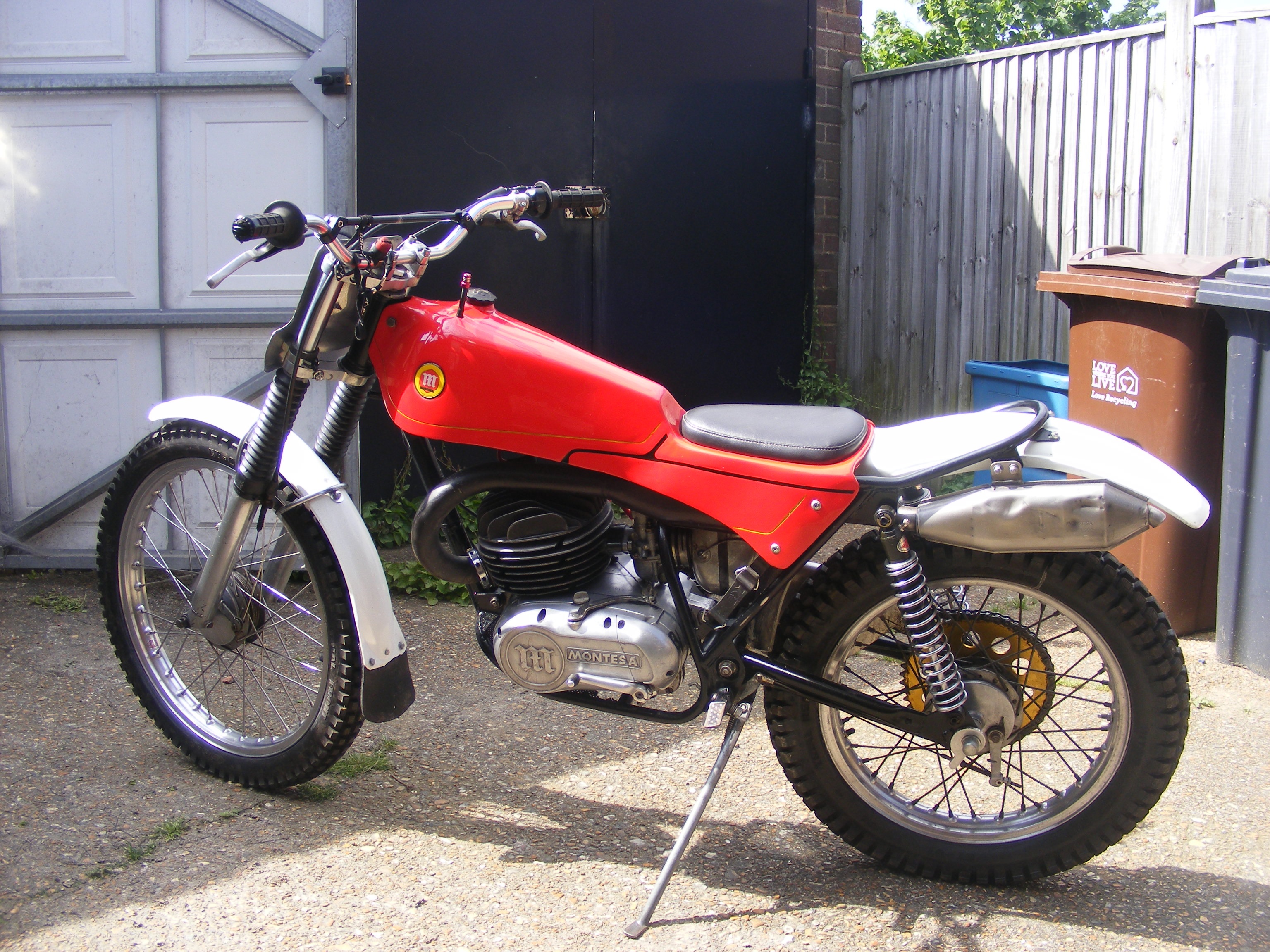

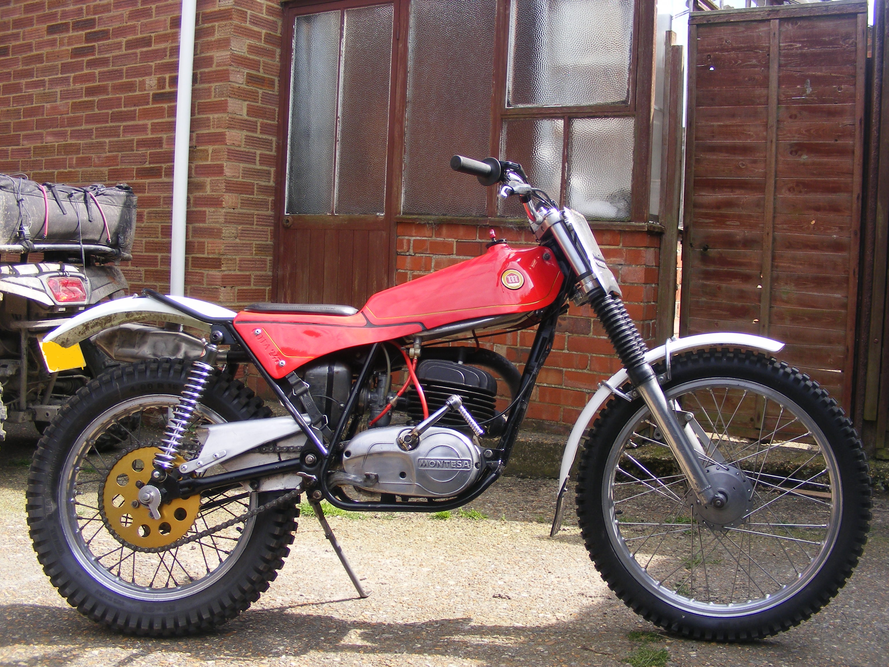

1 hour ago, dr nosh said:
That's a nice tidy example. Just restored?
Thanks.  yes, although by someone far more talented than myself..........:lol:
Very nice-looking 247. They do have very beautiful styling.
The air filter casing usually fits up close to the underside of the seat and has a hose with a 90 degree bend. I'm sure yours will work fine the way it is and only mentioned it in case things like that are important to you.
I see it has a MK1 AMAL carby. Beware of the throttle slide sticking at the top of its travel.
Thanks for pointer, must admit to thinking it was at a funny angle.
At present going around it just sussing out things to be done.............there is no chain tensioner fitted for example, where as I'm pretty sure originaly it would have had one (and there is a bracket halfway along swing arm which I guess is its location)
Re Mk1 Amal, is this a known fault with this model carb ? - and if so, how do users get around it, (yes I know there are other carbs out there often fitted...which is obviously an option if needed)
I'm pretty sure the air box is correct for this model that Andy has, being different to previous Cota 247 air boxes
Edited by fourex
Interesting , in the pic of air cleaner,............swing arm shows cap for chain oiler, I understand this feature was only on the early 247's...........although I'm happy to be proved wrong;  Certainly mine does not have this feature.
